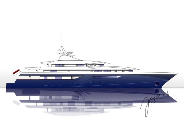

  6. Yacht News
    31,034
    The attached image by 'JMR' looks very Kogo to me.....did you get your 'inspiration' from the yacht Kogo? The rendering looks very good. Good job!

    I experienced recently also horrible beautifully designs and who that have to sacrifice are the poor engineers. Making good lines but do not know how constructions looks like is bad! They just make projects runs crazy:eek: Sorry too :)
    No, my 2D renderings is not inspired from KOGO, since I never heard before about KOGO. The hull lines of Kogo looks not correct...
    I do not know if my yacht renderings is good enough, but I understand something about ART since I paint alot with oil painting :cool:. Not everybody can do art..
    So LARS, DAVID, KELLY what are your opinion about my 2D renderings :rolleyes: Thank you yachtluver for your comments about my drawings...

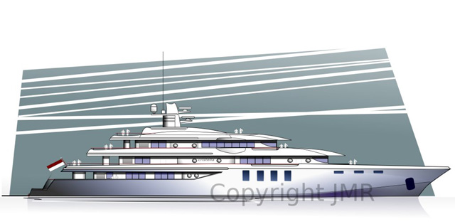

  9. KCook
    KCook Senior Member
    Jun 24, 2005
    1,159
    Phoenix
    Well that looks like a great yacht to me Jos. As for the presentation, I'm puzzled by the "leaning" shape of the background for the upper rendering. And the mirror image in the "water" on the lower rendering just adds confusion. I think simpler is better.
    Kelly
  10. jmr
    jmr New Member
    May 26, 2005
    52
    Hamburg
    Thanks Kelly,
    well I tried several type of renderings to make the scene more dramatical and dynamic, but without sacrificing the focus on the subject. I also tried horizontal, vertical and diagonal elements to see the effects on the subject. Anyway thanks for the critics..
    There are really masters in concept drawings outside in the CG world, I mean really masters in 2D...
    Jos
  11. AMG
    5,392
    Hi Jos,
    Well done as renderings, but you are not only making the engineers worried, you have to cut their heads off to get them in on two of the decks!:eek:
    Without a grid or measuring the headroom, it is very easy to create nice designs...:D
    Let´s see a new attempt! :)

    Ha ha...Lars,
    do they use their heads anyway :D ? There are alot of anonym engineers who finished the project but many designers have name and faces everywhere :rolleyes: so they do not need their heads :D
    Okay thanks for the critics anyway, but I am asking about the rendering style and styling and not design, since I am still an amateur ;)
    So I have to find a dummy human somewhere and scaled everthing properly....Maybe you have some hint where I can find a good one. Maybe a woman dummy!

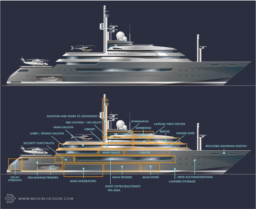

  13. AMG
    5,392
    On a napkin you are allowed to cheat on proportions, but not in a computer drawing...:D
    As you can see on this (oversized to read) rendering, I have all decks with realistic levels and the deck with the long window inserted in the hull is extra high to let the light in better towards the center where the boat is beamiest.
    You have probably seen that I always start with a grid when I create a new concept, which makes life much easier than trying to adjust a design later...;)
    (This 122m/400´ yacht is Diesel-Electric if you miss the main engines...)

  14. jmr
    jmr New Member
    May 26, 2005
    52
    Hamburg
    So at least I should take 3 meter height from deck to deck for a 75 meter vessel? Floor to ceiling 2,5 meter? Because there is no fix rule for every deck as I know. David maybe you can give some hints on this topic.
    I think the blue one with mirror on the water was not properly scaled, but the other one was properly scaled. Maybe the form confused your judgment Lars...
    BTW, I did those pictures in some of my spare time and made it in totaly 3 hours.
    Anyway thanks for your great pictures with alot of explanation Lars. Good work!
    Jos
  15. AMG
    5,392
    Not really, I made a grid on top of your drawing but I will not post it...:D
    /Lars

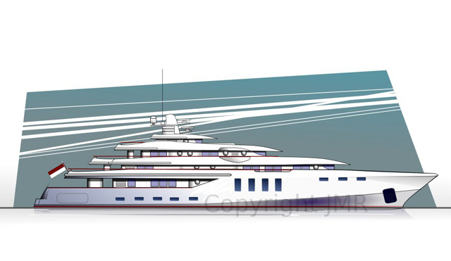

  17. jmr
    jmr New Member
    May 26, 2005
    52
    Hamburg
    Folks,
    made some corrections...:D
    Cheers!
  18. tartanski
    tartanski Member
    Nov 5, 2004
    116
    Hamburg, Dunnon, Buzios
    Feedback
    Jos the line art is great, I suggest removing the outline around the wing stations as the shadow/shading effect should make it clear that there are protrusions here.
