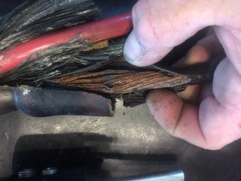

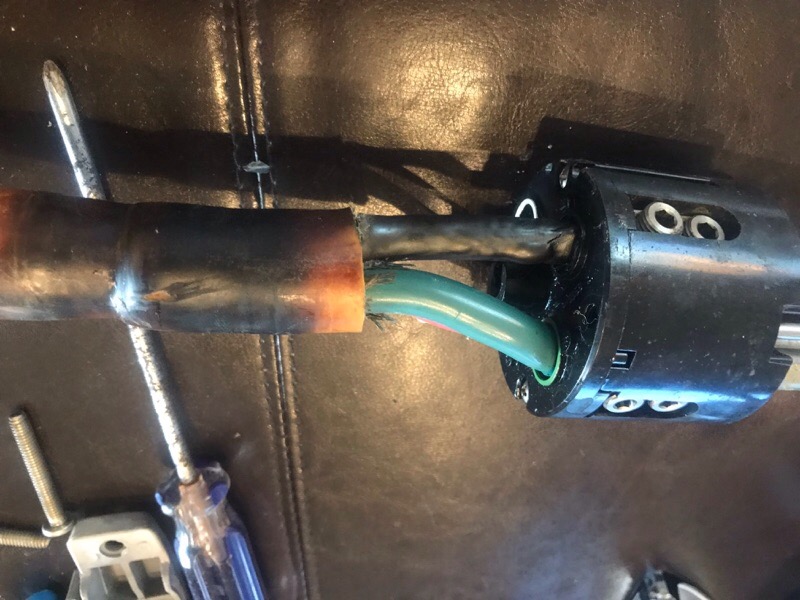

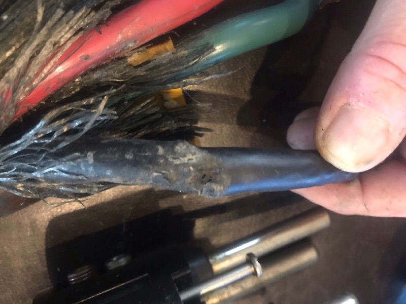

    Over the summer i ve noticed our shorepower plug and the end of the cord getting increasingly hot along with more frequent breaker tripping on the boat (the 100amp mains at the glendining)
    I just replaced the plug and indeed one of the wire was damaged. Looks like someone nicked the insulation when cutting the yellow jacket. Cut a foot off the cable to get nice and clean copper and installed a new marinco plug. Interestingly the marinco branded plug is made in germany by Mennekes. Yeah, not china!!

    That's some nice forensic detective work.

    What I see in the first picture the wire was not inserted far enough into the plug...……...look at the hex set screws closely , the second one in both wires is turned in much deeper suggesting only the fist set screw was engaged with the wire.

    Correct, the wire came out without loosening that screw
