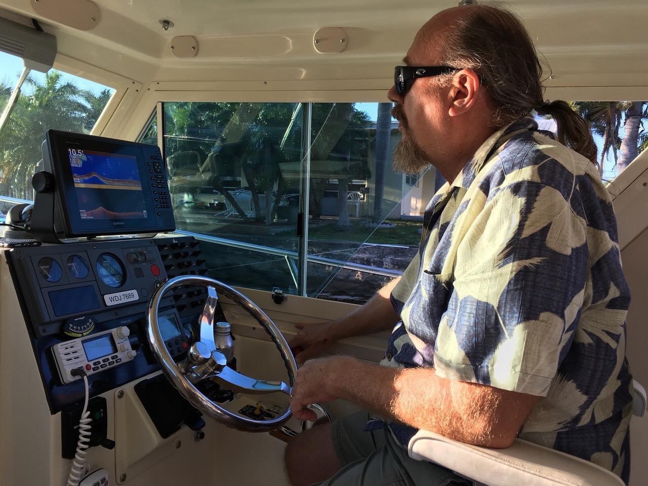

    True enough, I installed the biggest I could fit on the Mighty Albin 28TE, a 10’ Garmin. Good enough unit and right in the line of sight, it has served well.
    (No, it does not block the forward view, really. Had to cut the ponytail, too much attention from young women, wife hated it.)

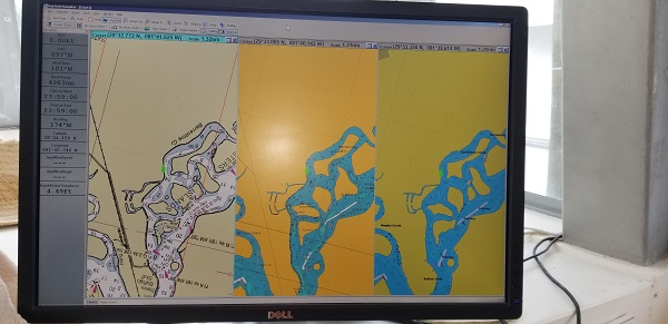

  18. Capt Ralph
    13,888
    Would a 27" TFT screen be large enough?
    With Navonics, C-Map and USGS Raster displayed at the same time?
