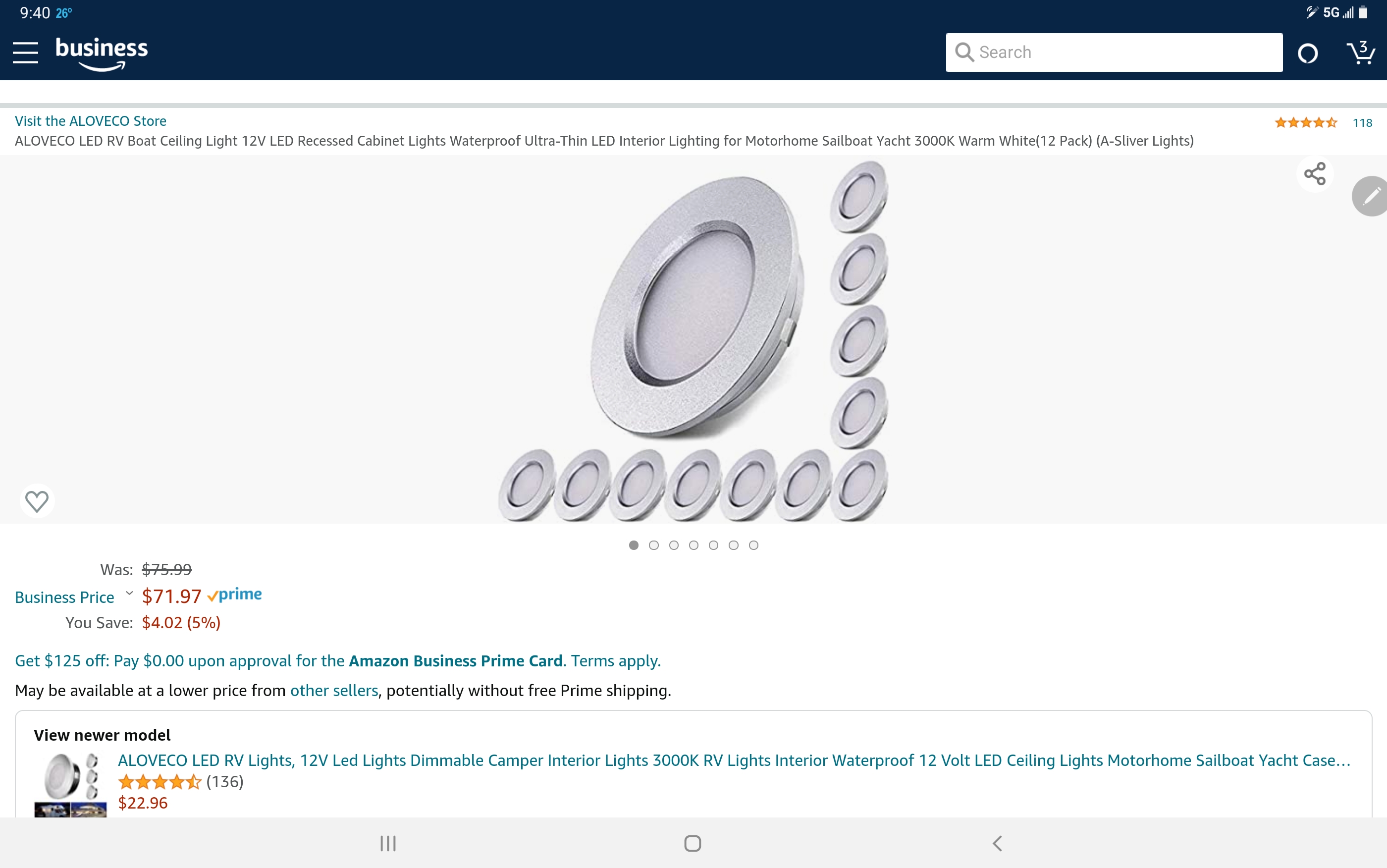

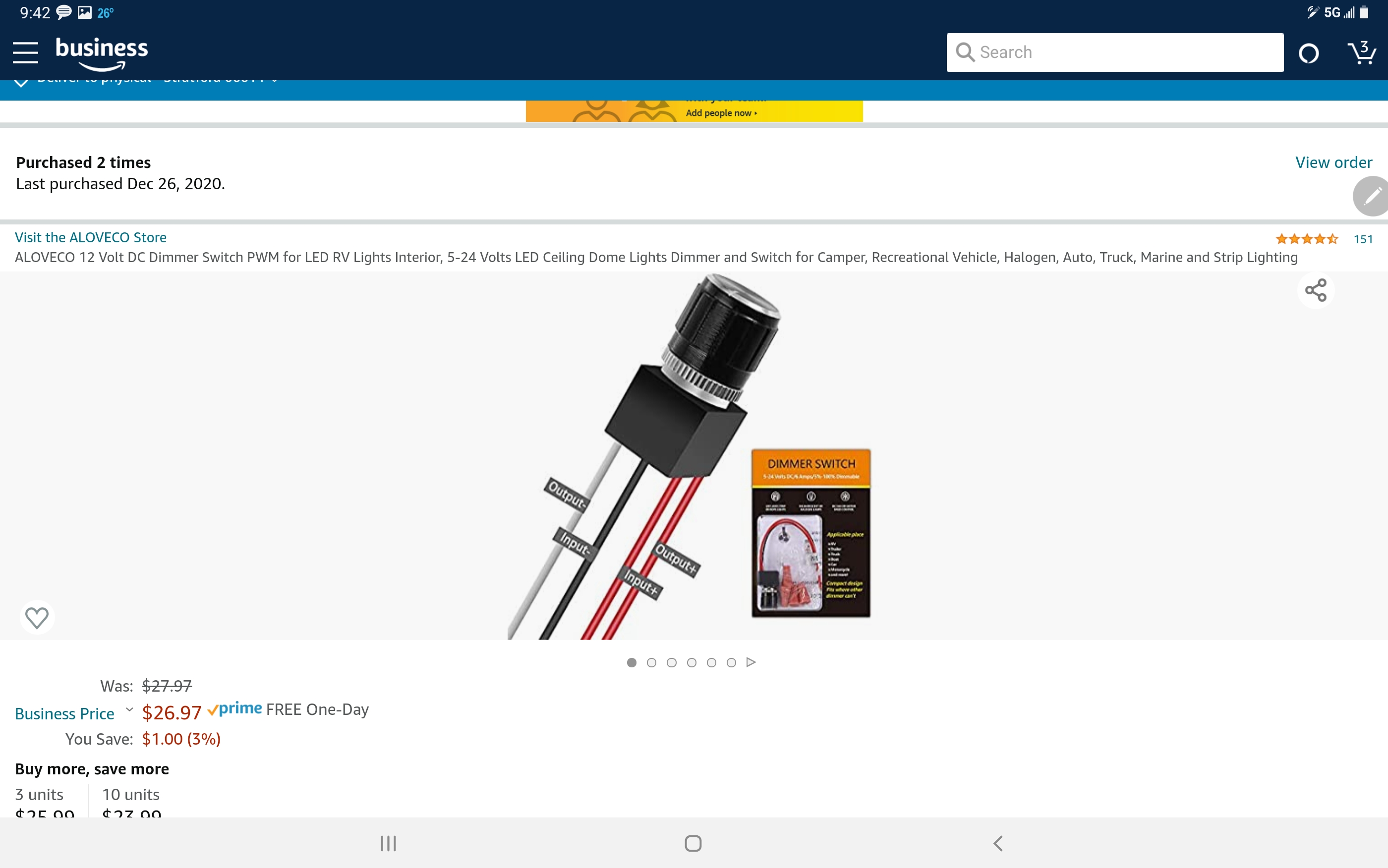

    Screenshot_20210308-094029_Amazon Shopping.jpg Screenshot_20210308-094300_Amazon Shopping.jpg I used these, They are almost an exact fit you have to clean the headliner under the old light really well As these are about a 16th of an inch smaller in diameter. They look factory once their installed but you have to use LED compatible switches

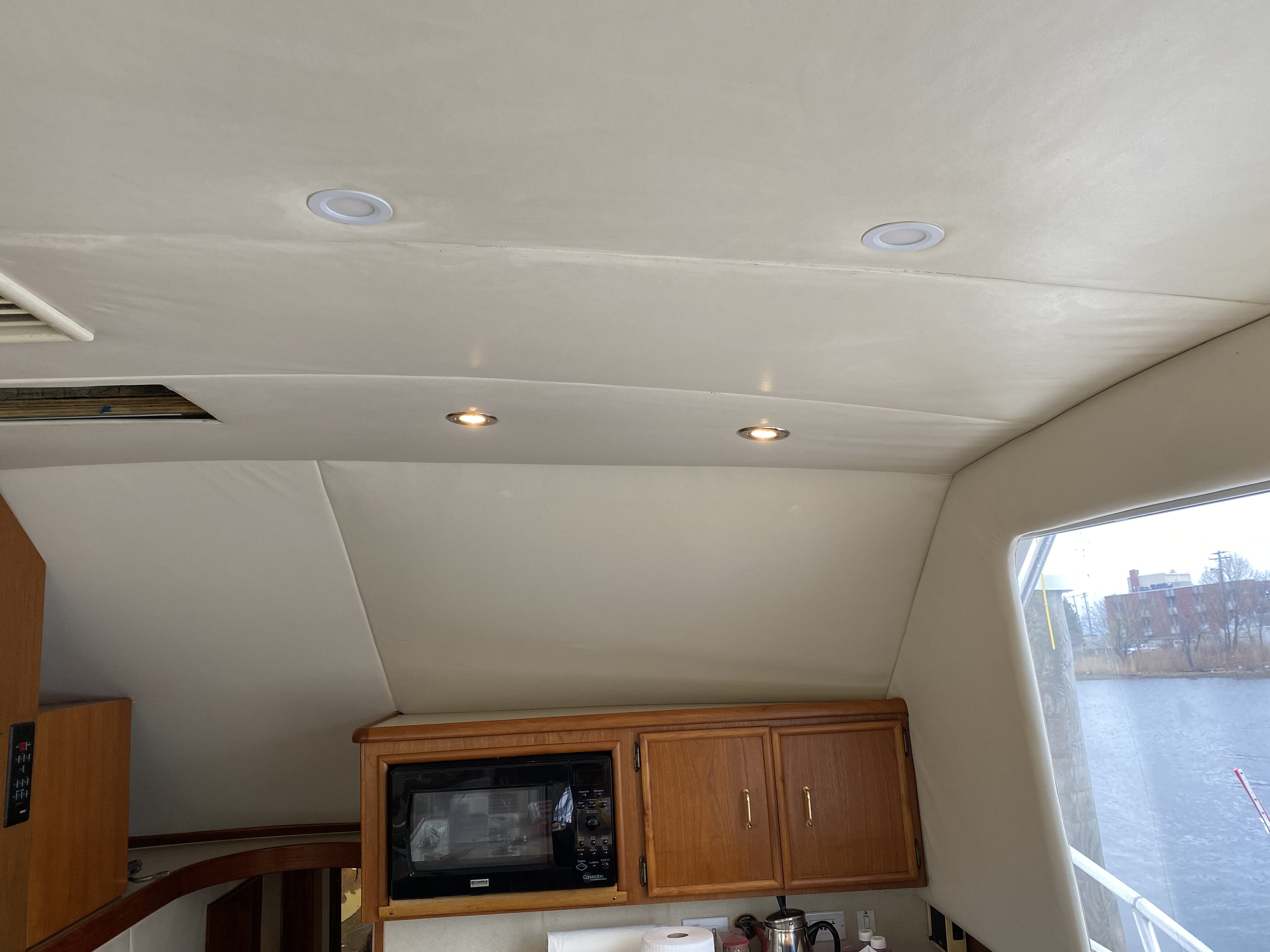

    B39B6183-6CA9-463A-92BD-B2DA6E80D084.jpeg I purchased the ones listed above on Amazon for my 48, trim rings are smaller but they fit nicely and work with existing dimmers.
