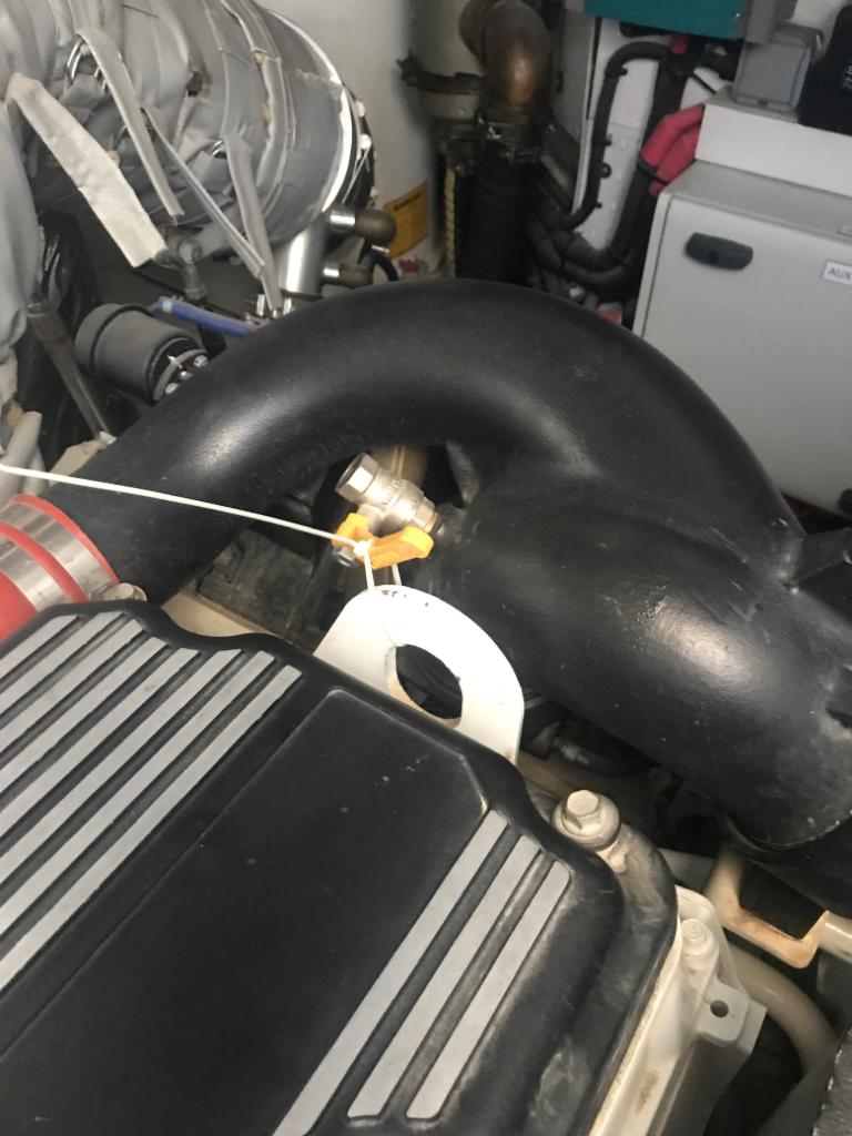

    The yacht is fitted with two Caterpillar C18 engines. The starboard engine will not achieve an engine speed above 1200 rpm. The local Caterpillar dealer has been struggling with the engine for months with no success and finally the engineer removed a blind plug from the turbo charger and fitted a ball valve in it's place which he left slightly open as seen in the image below. With this solution, the engine now achieves an rpm of 2300. However, I am not convinced this solution of fitting a relief valve to the turbo charger makes sense and cannot be a final repair to the problem. Something must be causing the problem and lack of performance. Any idea what the problem could be and why is the engine now performing as it should with the ball valve fitted to the turbo charger and left slightly open? Thank you.

    Your waste gates are not working causing a bit to much air.
    Or the pressure sensor is messed up.
    If your tech has the proper computer setup, he should of seen the data on his laptop.

    Thank you Captain Ralph. They do have the proper diagnostic tools but I doubt they have the ability to use it. We replaced the pressure sensors but the waste gate was not checked.

    Your beast have two turbos, in the back and on the side. I think each has a waist gate.

    I was told that waste gates on Caterpillar engines cannot be replaced and the complete turbo charger will need replacing if a waste gate has failed. Is this correct?
  7. Capt Ralph
    13,849
    Depends on the failure;
    It could just be stuck. Lil penetrate oil and patience may help.
    The pressure diaphragm should be serviceable.
    The shaft and internal damper would require a new turbo chunk.
    You should be able to move the external lever by hand.
    Has anybody recorded an actual boost pressure yet?
    Would you have any EGT or back pressure readings also?

    Still in process. The local CAT dealer is impossible to deal with. We removed the intercoolers and found the seals had failed and the intercooler cores were blocked with salt deposits. We cleaned them. The engine performance has improved and WOT rpm is now over 2250. The engine acceleration to 2250 rpm is normal until the coolant temperature reaches 70degc. As soon as the coolant temperature increases above 70degc, the engines start struggling going above 1200rpm.
