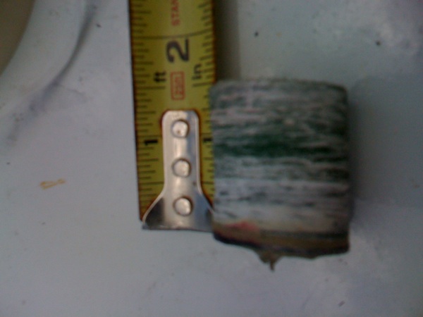

    by the way the photo is of a core from my 35 bertram hull ... the little black line is tri axil carbon that is right the good stuff most have never seen this stuff let alone worked with it... The green aria is where the core is on the newer boats if you feel safer with just 3 layers of carbon between you and you loved ones and the sea.. cool with me... you boat and life, but I'll keep my solid glass carbon bottom bert for life and tool around at 26k happy, and watch the new boats come and go....
    and 36 years at sea is better then any thing you can find to prove your point on the web, See my boat was one of a lot of tests that made bertram who they are and allows them to steal money from the un knowing to day. I took her out of service she was navy owned and live her whole life with water under her feat 36 years and was tide to the dock thro any storm that passed port everglades... it will take 36 year to see if your right by then my bertram will be 72y/o and seeing as she had no damage so far I'll bet my hull looks better at twice the age of an 36y/o cooler.....
