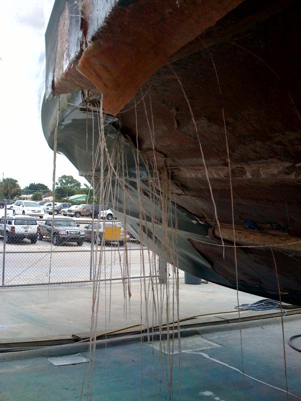

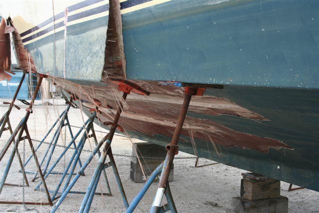

    Awaiting the exact story is behind these pictures. Seems like it's a new 63 that experienced catastrophic delamination in Palm Beach.

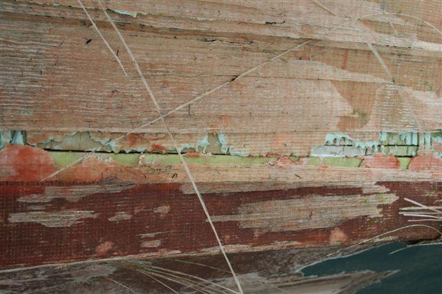

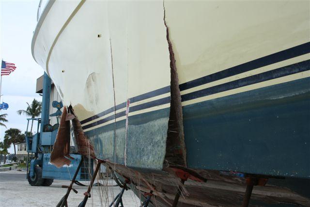

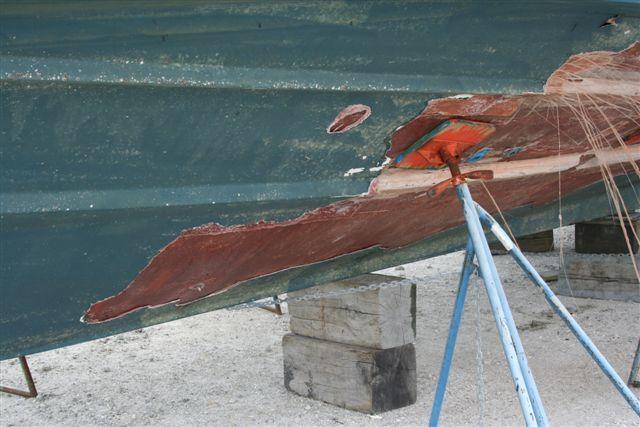

    continued...
  3. Pascal

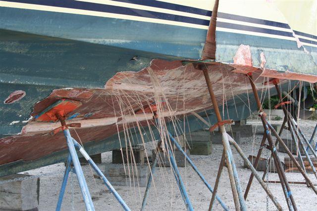

    8,950
    last pic.
  4. Fishtigua
    Fishtigua Senior Member
    Jul 20, 2007
    2,934
    Guernsey/Antigua
    Pascal
    My first thought is it maybe one of two screw-ups.
    1. The first major lamination was not applied while the gelcoat lamination was still able to styrene bond. Left too long at too high a temp or that the first mix was too hot this will happen.
    2. Moisture. Some builders have real big problems with humidity. Was it Wellcraft that had clouds inside their large lamination hall in South Carolina? I read an article about it in Professional Boatbuilder years ago.
    Once moisture gets on the gelcoat lamination its almost game over.
    It will be interesting what the surveyor says. Please keep us informed Pascal.
    Fish
    Edit:- I've just noticed in one pic that the delamination went all the way to the foam core. That is one nasty,nasty situation to be in. Are you going to name the builder or is that with the lawyers?

  5. Pascal
    8,950
    good idea... could you edit the title, i typed 67 but i think it's a 63... thks!

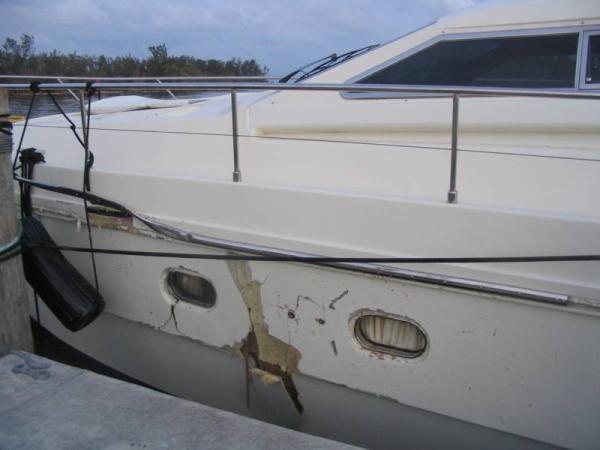

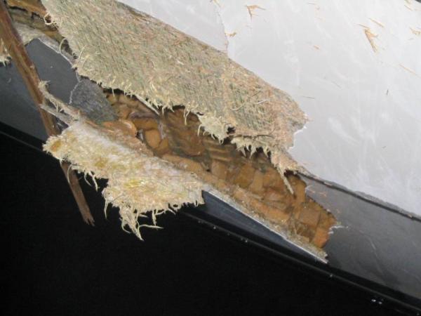

    btw, here are pictures of a 90s vintage Ferretti MY after hurricane Wilma in 2005. different failure obviously but there are signs of delamination on the Ferreti and with Bertram part of the Ferretti group, it's easy to jump to draw a parallel.

  7. Pascal
    8,950
    fishtigua
    it doesn't seem to be an issue with the gelcoat, it's really a problem with the outer skin delaminating from the core. Gel coat is very thin and brittle and woudn't flap like that, it will break.
    this is a Bertram 63, it's in the thread title...
  8. Fishtigua
    Jul 20, 2007
    2,934
    Guernsey/Antigua
    Sorry Pascal,
    When I say a gelcoat laminate I mean a first stage lammy.
    When you spray gelcoat into the mould ( up north, hopefully an Isothalic first coat to stop cracking in freezeing weather). After that has tacked up you then apply the first light weight glass, this is important to avoid print-through where you can see the roveing through the gelcoat, we've all seen it.
    After that the secondry laminate is added, however thick uni or bi directional is required for strength is required. After that the foam or balsa core is added to stiffness, followed by the bulkheads. These hold the shape for the deck to be added.
    Now all that should be bloody strong.
    Fish
  9. Pascal
    8,950
    yeah i know, but the bond between gelcoat and the first layer of glass is not STRUCTURALLY critical... here it's clearly the bond between the outter layer and the core that failed.
    although, not to be picky, but you ommited the inner layers from your description :) i'd hate to see a hull with the core exposed inside :)

  11. Fishtigua
    Jul 20, 2007
    2,934
    Guernsey/Antigua
    Pascal, you are right. The core should be totally encapsulated. Why the hell did it break away? Weird.
    I hate to say it but a Friday afternoon lemon like the bad old days of Detroit springs to mind. Should he take it back to the factory and set fire to it in the lot like the guy with the Caddie did??

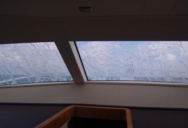

  12. YachtForums
    20,967

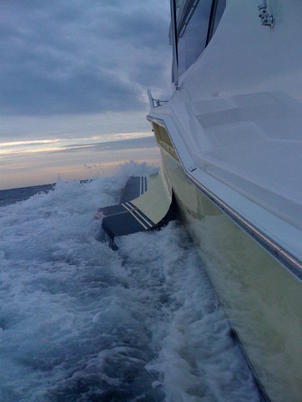

    I sea-trialed the new 540 Bert last month and subsequently declined to do a feature on the boat. The boat was fast, very fast! 42 knots to be exact. But, it was a very wet ride. It was evident that neither Bertram, nor the design bureau of Zuccon International had done their sub-surface homework. This boat needed spray rails, or at the very least, reversed chines.

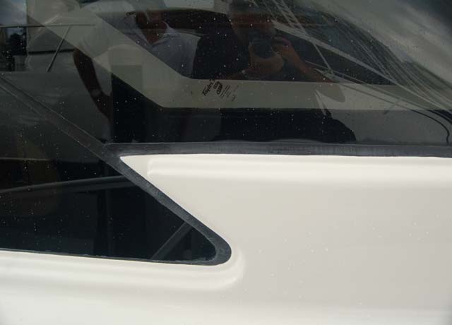

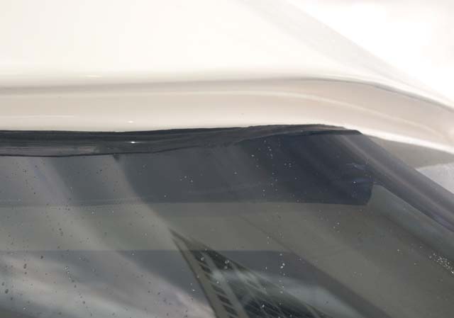

    And there were other issues. The much noted Taylor-Made ‘wrap-around’ windows didn’t match the curvature of the superstructure. The edges actually poked-out. Worse, Bertram is using the using old-school method of smearing the gaps between the windows with silicone rubber. It’s only a matter of time and ultra-violet exposure before this material degrades and the windows become a liability, not just a leak, when a wave crashes over the bow.
    There were some other fit and finish issues, including irregularities, age-old appendage molds and some everyday, common sense things that would become long term headaches. So many in fact, that I told their marketing people that if Dick Bertram was alive today, heads would roll. Realizing my comments would sever any support, press releases or sea trial privileges in the future, I believe the liability of misleading our readers would be greater.
    That said, the boat was still impressively fast. Of course, if you put 1200hp MAN’s into anything that floats, you’re gonna fly. The interior was top notch with good joinery and finish, although it is not built by Bertram, it is sub-contracted. Mechanically, the boat had all the right equipment, but the machinery is only as good as its foundation. Without the security of the legendary Bertram lay-up underneath you, the ship’s systems are meaningless.
    Here are some pics from the sea trial...
    1. Seam is already beginning to degrade.
    2. Sloppy seam around windows.
    3. View from salon shows how wet the ride was.

  14. Capt J
    14,905
    I know the surveyor that surveyed this boat. He thinks as well as some other people involved with it, that they forgot to put hardener in the resin at that stage when they were laying the hull up.
    Needless to say I too think Bertram lost it. I ran a new 57' Back in '05. It was very wet also, fast (31 knots @ 1950rpms with 1300mans), it pounded in 3-5's. AND, all of the tabbing from all of the bulkheads to stringers broke loose within a few months of use (heaviest sea was 5' the boat was in). The factory said that too much hardener was added to the resin which made it brittle. The factory did such a wonderful job of keeping the owners boat for 4 months and extending his hull warranty for 1 additional year. Yup, 1 year. I told him to hire an attorney and make them buy it back.
