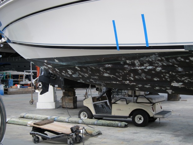

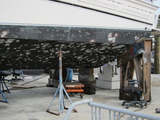

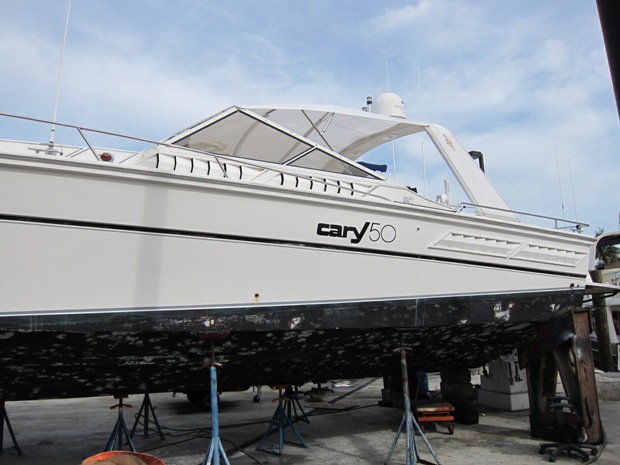

    Be sure to check the bottom of the Cary you are considering. Here is what the bottom of White Lightening looks like. They are still working on the drives.

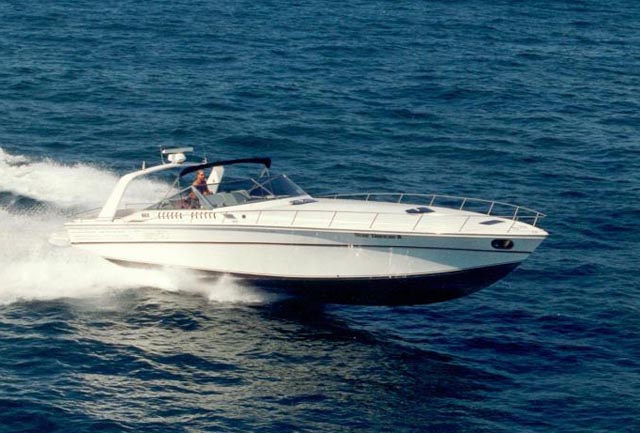

    I will try to up load some pictures but not much luck so far
  20. SHAZAM
    SHAZAM Senior Member
    Jan 26, 2008
    601
    The Ghetto
    Judging by the windshield, that's got to be a late 80's early 90's 50. This windshield was the factory's attempt at modernizing the boat, the bottom of it still fit the angular base from the older boats while the top had a slight curve. Also, has anyone ever noticed that the deck hatches on the original carys are nothing more than aftermarket automotive sunroof/moonroofs?
