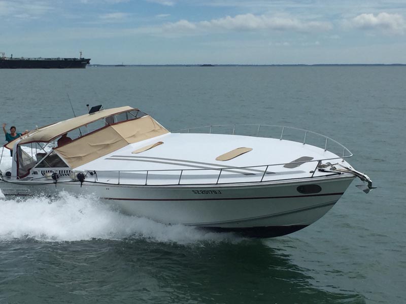

    I bought a Cary 50 last year took out 2 of the four engines and lightened up the boat to approc 22000 pounds.i replaced the TRS drives with konrads. Boat now does 28 knots with 600 ltrs of fuel.

    The main issue now is to replace the 540 ci v8 engines with diesel engines. But not hp or which engines to go for. Anyone have any suggestions?

    The cummin previous 6bt diamond series around 450 hp 3000 rpm may be option based on power to weight. The konrad 520 should be ok up 450 hp diesel. The 540 ci v8 are 550 hp each.
    I guess i need to look at lightening up the boat even more. The interior fwd cabin, sofa area and heavy wood iterior structure would less off probably anothet 500 kg. I also found over a 150 kg of ballast lead under the galley. Redicullous!
    Have removed all the old floresent tube lights. Must have been over 20 of them. Not sure if any one had owned one of these cary's but the hull need loads of hp to get out. At present with a clean bottom she will plane at arond 18 knots. Just.
    Rpm 3200. With 5 blade 19 x 19 . Max rpm light n clean 4600. Fuel burn with just the two is outragious!
    I can get a realy good price for the new steyr around 280 hp each. They are very light and the hi rpm matches the konrad 1.8 ratio.
    Hp a bit on the low side and they are not very torquey engines.
    The other thing i aso thought about was giving the hull a bit more lift by increasing the flat lift area especialy at the stern and sharpening up spray rails etc. Any other ideas out there to try and to get the best out of this old girl. By the in ruff nasty short wave sea here in asia its a dam solid boat. Infact very impressive sea handling and without getting wet from bow spray. So to me she is worth keeping.
