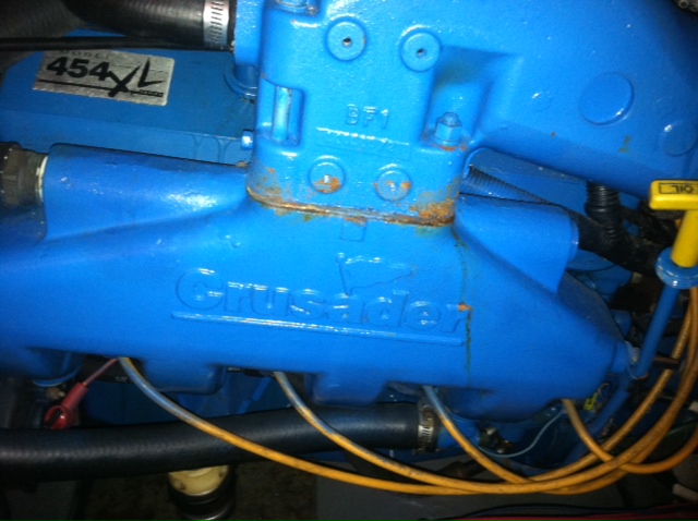

    On behalf of user "ADAMBOMB"

    Sure, some rust where the mani meets the elbow, but I've certainly seen much worse. I'm not an expert but I love to research and read, and from what I've read the most determining factor is your engine temperature due to constricting water flow. I know on my 350's I stay at 170 deg's F or below WOT. I'd guess that you probably have 454's and temp shouldn't exceed somewhere around there either, maybe a bit higher since you're FWC with a heat exchanger. What does she show WOT? Tom.

    the weaping in that pic does not seem excessive.
    To me, that pic alone withouth anyother heating related issues would not be a concern.
    hit it with a wire brush, re Tq the bolts, and hit it with some paint...
    and keep an eye on it on your maint schedule.
    you should be able to get 2-5 years out of the risers.....
    When I was running a gas boat, i changed or boiled the risers every 2-3 years, it was part of my maint schedule
    A suggestion, use a IR temp gun to check the mainfolds and risers in different locations, both engines should be pretty close (but not exact) to each other.
    If you get used to checking the risers (while running and at idle) you will notice the temp differences and know when you have a problem creeping up on you so you dont get surprised on a trip or at someother wrong time.

    Has anyone had damage to a motor due to water ingestion or usually just overheating when the risers fail

    the joint between the manifold and riser gets alot of expansion and contraction because that is where the heat is transferred from the coolant to the raw water. The manifolds and risers are cast and there is a SS block off plate and some gaskets at that joint. There is alot going on there.....
    I think a small amount of weeping and minor surface rust without anyother heating related issues in not a cause for immediate concern
    keep an eye on it though....
