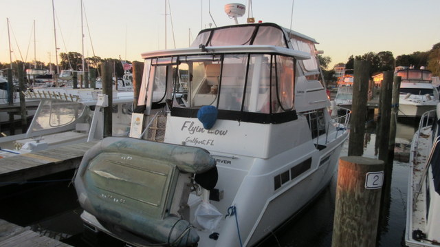

    I have just acquired a Carver 355 1998, however it is closed up for the winter as are all the boats in this area. Perhaps an owner in a more southern climate can get me some of this information.

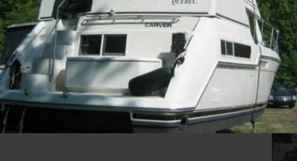

    I need measurements of the swim platform.
    Front to back, (the depth), side to side , from the right side edge of the spiral STAIRCASE , all the way to starboard inside edge.
    On the swim platform, in the case of those of you with boats that have the storage dockbox on board, what is the height of the top of the box, and at what height is the top of the window. Also , how far is it set back from the edge of the platform
    I am giving up using the flip up style davits as I do not want to continuously remove my now heavier engine on a soft bottom dinghy, so I am looking to put on Hurley Davits, which maintains the boat in a flat position , ready to go, with everything in it.

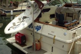

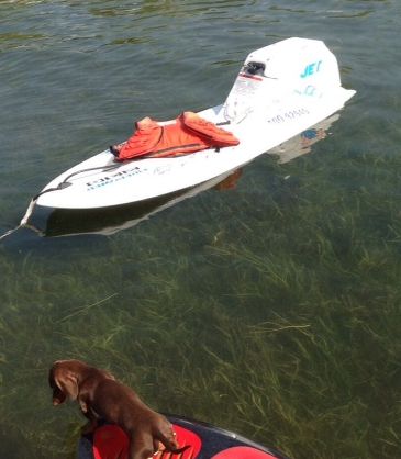

    In addition to this, I have a SURFJET, a motorized surfboard, which I would like to put either on the deck in place of the deckbox, or on a cradle resting just above the aft window , immediately to the right of the stairs. I will assemble a hoist for lifting this.
    Also, just above the emblem to the right of the handrail, what is the height of the opening to the rear upperdeck below the plastic in the photo. I will need access to stanchions for securing my items.
    Thanks to anyone who may be able to assist me. It is about to be a long winter.

    A the surfboard
    B THE REAR OF THE Carver (from stock photography)
    C showing how it was hoisted on my 30 foot Searay across the rear and onto the taff rails to a cradle.

    Me thinks you're trying to put too much on such a boat. My weaver davits with weaver leaver works quite well.
    Measurements: Best to do that yourself, big trouble if you rely on someone else.

    Your swim platform will take a 10' RIB on a Hurley H3O. I have a Carver 404 with a 11' RIB and it's an awesome davit. Half of the boat hangs off the edge of the platform, so you can put almost any 10' model on board....If I could reduce my photos I'd post a couple!

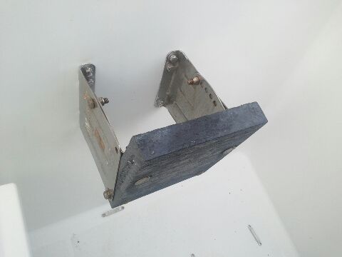

    Thank you for your reply , which I appreciate. I notice you are using the weaver lever. What size engine is it supporting. I also notice that you also have an engine mount bracket on the right side of your transom. Do you ever use that. At what point would you bother to lift of your engine.

    Motor mount you described was installed by previous owner and I don't use it except for winter storage. It does store my 8Hp Johnston O/B quite well which is used on the weaver leaver.

    I wanted you to know that I did contact Carver Yachts and there was no way that they could help me. for a 1998! I also reviewed the pictures of the actual boat I have purchased and realize that my deck box is not the full width, which means i have space on its right hand side.. Do you have any idea how the motor mount would have been attached, (back plates etc) or if it is strong. I may use it as lateral support for the mini crane that I wish to install.

    I didn't install the mount so I can't say if it has a backing plate. It does seem strong and I have carried the 8hp outboard on it several times. However the motor rests on a plastic plate attached to the swim platform when installed on the mount, so the mount doesn't really carry all the weight of the motor.

    It might look like too many toys,but this boat is now bigger than my 30, and the jet is only 120 lbs ,so overall in weight its like havinga kid at the back. See the photo of what and how i lived on the 30',a dinghy up at the back against the jet across the top of the taff rail, blocking my seat. I suppose if i went to the trouble of having the upper deck crane, i could put it on the roof, but then i would hesitate more often from using it or putting it away .
