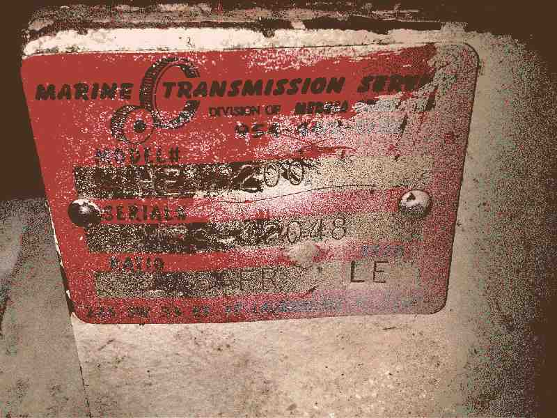

    It's a 1981 Capitol HE 10200, picture is not so clear, but make a new one today.
    Ratio is 1.5:1
