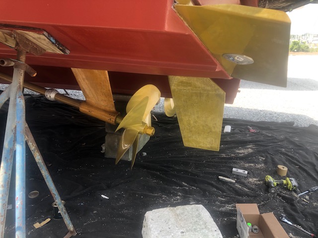

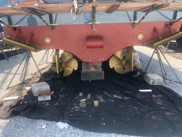

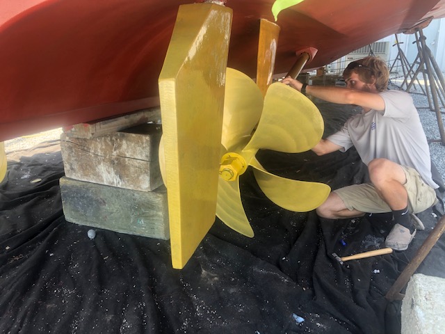

    I geezed on the rudder access. It's the struts that are under the tank. Rudders are in a huge lazarette area.
    One shaft is new and we inspected the other but it was not removed and sent out. Magnafluxed in March.
    We have a Sunseeker here that the props were not installed properly and ended up with cracks out from the keyway. Props snapped off the shafts, one at a time 2 seasons apart.
