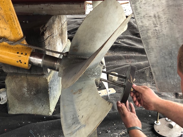

  15. 993RSR
    993RSR Senior Member
    Jan 15, 2004
    577
    Annapolis/ Palm Harbor
    Props are off!!! Yoo hoo... So if the hubs had so little contact with the shaft why were they so tough to get off. Prop guys said the keyways were twisted. These props are 20 year old Teignbridge that have been repaired/reconditioned 15 times over the years. Ready for the recycling and on with the new Veems as we speak.
    Boat is a Eastbay 49 but its not a boat issue.
  16. 993RSR
    Jan 15, 2004
    577
    yes they returned with custom machined heavy plate to use the hydraulic pump. Even then they needed heat and a few taps.
  17. DOCKMASTER
    DOCKMASTER Senior Member
    Feb 26, 2012
    1,661
    Ketchikan, Alaska
    Obviously the key ways being twisted are a contributing factor. Further, as others suggested earlier in the thread I suspect you had an excessive interference fit issue whereby your props were warm and shafts were cold when they got put on.
