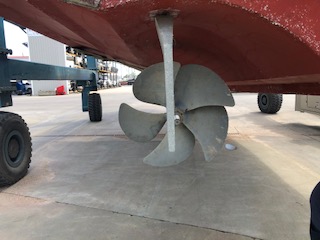

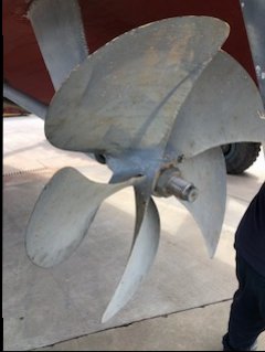

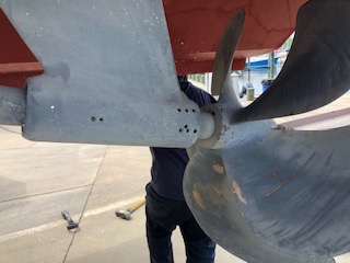

    Hauled today at 11:15 and the shop worked till 2:30 trying to remove my props. They would not budge.
    First they used a puller with two threaded rods into the hub and a torch. Destroyed the puller.
    Next was a chain puller and torch. The hub fittings failed on the chain puller from all the torque.
    We are trying to avoid driving my shafts into the gears with a sledge.
    Any tips?
    Fortunately these props perform fine and there is no emergency to get them off so I went back overboard.
    These are 5 blades with two threaded holes on 2 1/2 shafts.

  15. 993RSR
    993RSR Senior Member
    Jan 15, 2004
    495
    Annapolis/ Palm Harbor
    Bert Jabins is the yard that pulls the boat and the contractor who is doing the prop swap has done the swap on this boat twice before.
    PropSmith will not work as we only have 2 threaded holes in the old props. We have one for the new props

  17. 993RSR
    Jan 15, 2004
    495
    What do you think?

  19. d_meister
    d_meister Senior Member
    Mar 4, 2010
    468
    La Conner, WA.
    Yes, that kind of setup with a port-a-power puck between the shaft end and plate, like THESE guys have. I would forgo the hammer option and try to get two large rosebud oxy acetylene torches on it, one on each side. Try to get the heat in an area away from the puller rods, lest they warm up enough to stretch.
    Don't forget the safety chain . The props get rather damaged when they fly off and land on the ground. If you can have a prop nut on along with clearance for the puller rods, that's better than a chain. It depends on the size of nut and hole spacing.
    Been through this several times on larger yachts I've run, and as you said; deliver heat quickly. Done with enough fast heat, the shaft won't even get very warm behind the cutless. Haven't melted a bearing with this method yet.

  20. Capt J
    14,432
    If they were already removed once, they weren't installed correctly the last time they removed them which is why you have the problems you have now. Either the key ways are too tight, and/or the props were not lapped to the shafts. Check key way fit in both prop and shaft and massage the keyway a bit, always lap the props to the shaft (spinning them on the shaft without the keyways with valve grinding material).
