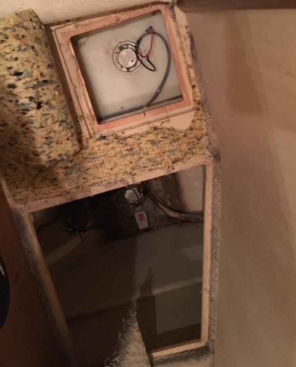

    Found it! We are replacing the carpet next week, pulled it up and found the water tank immediately forward of the forward bilge access in the master.

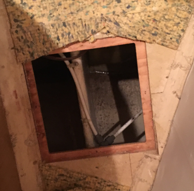

    There is also an access panel at the foot of the v-berth. Good to know if one ever needed to access pipes at the front of the water tank or rerun the sanitation pipes to the vacuflush under the v-berth.
    I would need to enlarge the 1’ by 1’ opening to actually do any work.

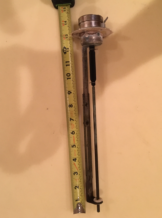

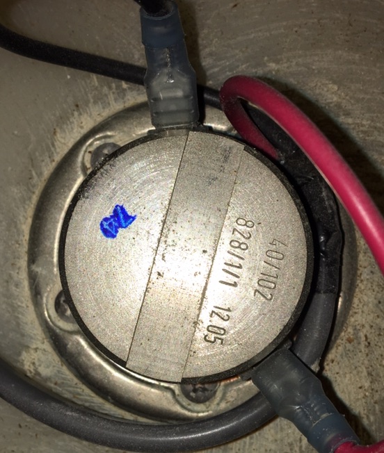

    I pulled the sender. Can’t figure out how it works or find anything like it on-line. Please help me identify it or recommend a reliable replacement. The access will be under the nice new carpet. Thank you for your help.
  13. Capt Ralph
    13,866
    Float assembly is missing. Floating around in the tank still.
    Yep, looks like a screw came loose.
    If I remember, it's a white plastic float, wire rod as long as that sender is deep and the hinge / gear assembly.
    Pump some water out and go fishing with a coat hanger wire. in the mean time, nuts, washers, screws and float assembly are rattling around in your tank.
    As the float rises and falls, pivoting at the bottom, gear drive would rotate the shaft. The sensor at the top would give the level value to the gauge.
    This is usually a good sender. Fix it if you can.

    Treasure Island, Florida
