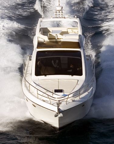

    What question? The deck barely slopes. The cap is what slopes while the deck is pretty much level, which gives it the illusion of the deck sloping. Go to Azimuts website and look at the 70' MY which is depicted in Post 1. You can see all kinds of pictures of the foredeck and it is a very safe foredeck to be on.........
    If you really want to talk about unsafe foredecks.......you should really be talking about a lot of Sportfish, raceboats and such.
  3. NYCAP123
    11,209
    Let me write it more slowly for you. When you stand at the rail working lines, and you place your knees and hips against the rail so as not to fall, do your feet stand on a flat deck or the slope? What's straight down from the horizontal rail between the stancions?
    I don't give a rat's behind about slopes allowing you to see an extra 3' when you're cruising. I don't give a rat's behind about square bow designs. I've never commented on that except that it's done for style purposes allowing designers to once again cut the amount of actual boat you get in a given size, and it appears to have been done at the expense of safety. I'm quite familiar with boats being designed by people who have no concept about how things work on the water. I know you've stated that you're not concerned with your crew's safety, but some of us are. You've been insisting on twisting this thread in a way to start a fight. You're not worth it. So how about an answer to what my question has always been about. You say you've seen this boat in person. I only have the picture to go by. Where will the deckhand's feet fall when he works the rail? What's straight down from the horrizontal rails between the stanchions?

    Looking at the Azimut 70 Fly, your feet will be on flat surfaces. If you so choose to use the small ledge to brace yourself, then nothing stopping you. The stanchion is about an inch on the raised surface which gives you a forward tilt of perhaps 2%. By comparison, looking at a Hatteras 60 MY, the stanchions are also on a raised surface about the same distance from the flat surface but raised more. The one big difference is that on the Hatteras when you're all the way forward, you would have to step up on the raised surface plus step around the windlass which is more out of the way on the Azimut. Also, the Hatteras does not have the additional cross rails of the Azimut.
    I would consider both boats rails safe. But if I had to say one was safer, then I'd choose the Azimut. And this comes from someone who would choose the Hatteras boat long before the Azimut.
    I'd suggest going and taking the virtual tour on the two boats as both have one. I have been on the Hatteras in person, have not been on the Azimut. There are many things I might criticize on the Azimut but this is not one of them.

    Looking in a mirror, instead of the third exterior pic of the link?
    Astondoa 55 Fly . Astondoa Yachts . The magic of seduction

    Looks to me that the top rail is one continuous piece especially above the 1st port side stanchion. If so does that mean you open the gate below it and duck down below the top rail to get on and off at the bow, then again thanks to the angle you could open the gate sit down on the deck and slide down quite nicely.
    If you use your link and open the "brochure" for the 64 one can see the severe angle the forward rails are set at.
    I think I will still take my chances on a good old 53 hatteras, deck boxes, spare anchors and all. At least I will know I am in an upright position with my feet planted firmly on the deck and my legs & body in a vertical position.

    The conversation was getting a little crazy and needed a frontal pic to see the relationship of the deck, railing, and slanted edge.
    Astondoa was mentioned in the OP, so thought it fair game to include, since it was the only frontal pic readily available.

    A few months ago I posted a picture of the 72 Astondoa I with no rail and a raised platform where the cleats and windlass are. Yes, no rail whatsoever... That one was definitely the worst foredeck I have ever seen.
    I guess most buyers feel the same way as the boat never sold and it is now chained to the dock with 24/7 security guard and no trespassing lien signs. Along with a smaller astonda and two other boats.
    Maybe it all comes down to how boats are used. I see where guests tend to go while we re cruising in protected waters and many go to the bow to enjoy the view and the breeze. When we have 10 or 12 people standing on the foredeck, it's nice to know they won't trip on the windlass and that every square foot of space is usable to stand. When the deck stops 18" short of the end of the hull, it's wasted space.
    And yes, whe you have railings which are angled forward, they are basically useless because you can't lean on them and you can't barely grab it to hang on should the need arise.

    I agree that you can't lean against an angled bow rail for comfort, but most cases you can lean/ brace yourself against it for docking purposes. Each builder tries to achieve different features and sadly most put form over function these days but the buyers are the ones driving that. The buyers want sexy over safe and functional.
    While I'm not certain of this but it appears with the new Azimuts that they are designed to med moor the bow against the seawall and the front gate opens and therefore having the rail leaning so far foward gives you something to hold onto when entering the boat from the dock in front of it. I haven't paid attention and will take a look at the Azimut on C dock at Bahia Mar this week as it is docked bow first. I do feel the Azimut bow in post 1, is a plenty safe enough bow to work from getting fenders to launching the anchor and such. It seems to have plenty of railing and a flat enough wide walkway and deck. Wouldn't be my first choice, but certainly wouldn't be my last choice. I also do like the extra cross bars in the bow section.

    My beef with the mutt in post 1 wasn't really safety, but loosing deck space with the wide angled toe rail although I like vertical rails for safety.
    Like most here in the US I almost never med moor and lack experience but it seems that med mooring bow first would be pretty rare due to the additional pressure on a boat moored stern out in most places.
    That said, we sometimes have to bow in, either hovering to drop off/pickup someone or simply because the place we need to tie up is too shallow to stern in and an opening bow section woudl come in very handy to step from to the pulpit onto a dock :)
