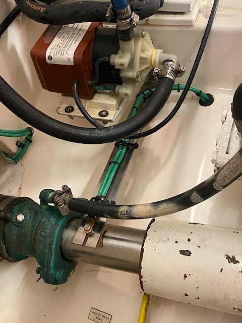

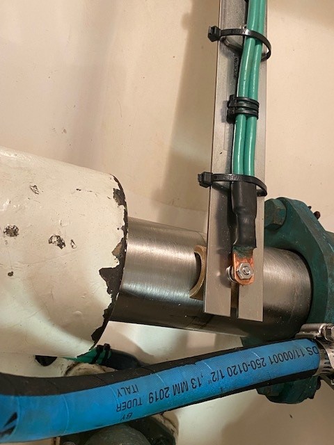

    Installed the new shaft brushes.

  2. Capt Ralph
    14,574
    Sweet and clean.
    A thought;
    Your water injection to the shaft log seal assembly, that street 90 and nipple, Is that brass or bronze?
    Maybe something to ad (to the bottom of your work list) to check them out.

    The water injection fitting is bronze. When I haul the boat both shaft glands are going to be removed as I’m going with PSS seals.

  6. Capt Ralph
    14,574
    Unless you know a trick, those seals must have the shaft / coupler separated to replace that seal.

    The mechanical seals in the above photo are the original from Cabo. They are in decent condition, however the stbd one overheated due to scale blockage in the cooling water line. I have good water flow now and they are both preforming well. I’m not sure of any damage caused when water flow was restricted. We will see when I haul the boat out later this year.

    When I had my Cabo43 they recommended no zincs on the shafts.

    Understood - no shaft zincs are going on my 40 Cabo either. New shaft brushes were installed which are common bonded to the transom zinc.
