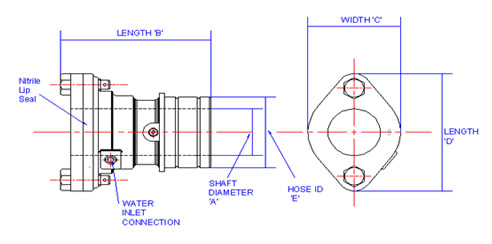

    See the small hole in the first diagram, not the one for water but the one dead center? That's where the grease fitting is. Mine has a cup for grease but it sounds like from bglad's post it could have a zerk fitting.
    I checked out a couple of 35 flybridge and it was behind a bulkhead. Kind of hard to see. Which Cabo do you have?
