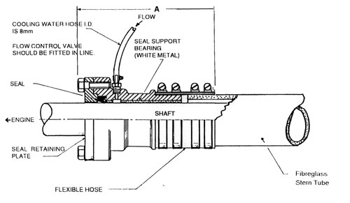

    If you can get the front plate off which they say can be used in an emergency to hold a packing in place you should be able to wipe the front face of the seal and read the dimensions off it, if not you should be able to measure the bore and shaft accurately enough to go to a bearing shop and see if you can buy the seal on it's own.
    I would be surprised if it were a proprietary seal in use by such a small volume manufacturer.

    I see my last post to you has vanished ... make sure you look at the babbit bearing inside that p.o.s. seal and you will probably find it is worn at both ends (hourglass shaped) from the shaft whipping.
    The seal is a victim, not the perpetrator, of your problems.

    I do have the Chatfield Shaft seal on the boat except mine is not the commercial one. I believe the one you are showing is the commercial one and my is the standard. go to www.chatfieldmarine.com, driveline, shaft seal, standard. Any comments are welcome.

    I figured you might not have the commercial one which is why I wrote It's a pity you don't have one of these before posting the link.
    Marmot, You got a better cross section of the seal assy than I found on their website, I must say the www conn on my IPhone isn't very good from the bottom of a 8000 gal black water tank or I would have replied sooner :).

    It isn't your iPhone, Chatfield doesn't provide that drawing on its website. That is why the link goes to another supplier.
    The cynical Marmot believes the manufacturer doesn't really want anyone to know what the weak points are.
    I don't know but I suspect it would cost more than it's worth to renew the liner. As a matter of opinion, I believe it costs more than it's worth to put a $5 seal in the thing. I believe someone else mentioned that Cabo no longer uses that style. If that is the case, their reasoning is becoming obvious.

    It looks in that drawing that Marmot found that the white metal brg is only used to hold the seal in a straight line with the shaft, Marmots suggestion that it may be goosed at the ends is a pretty valid one given how it is actually constructed.
