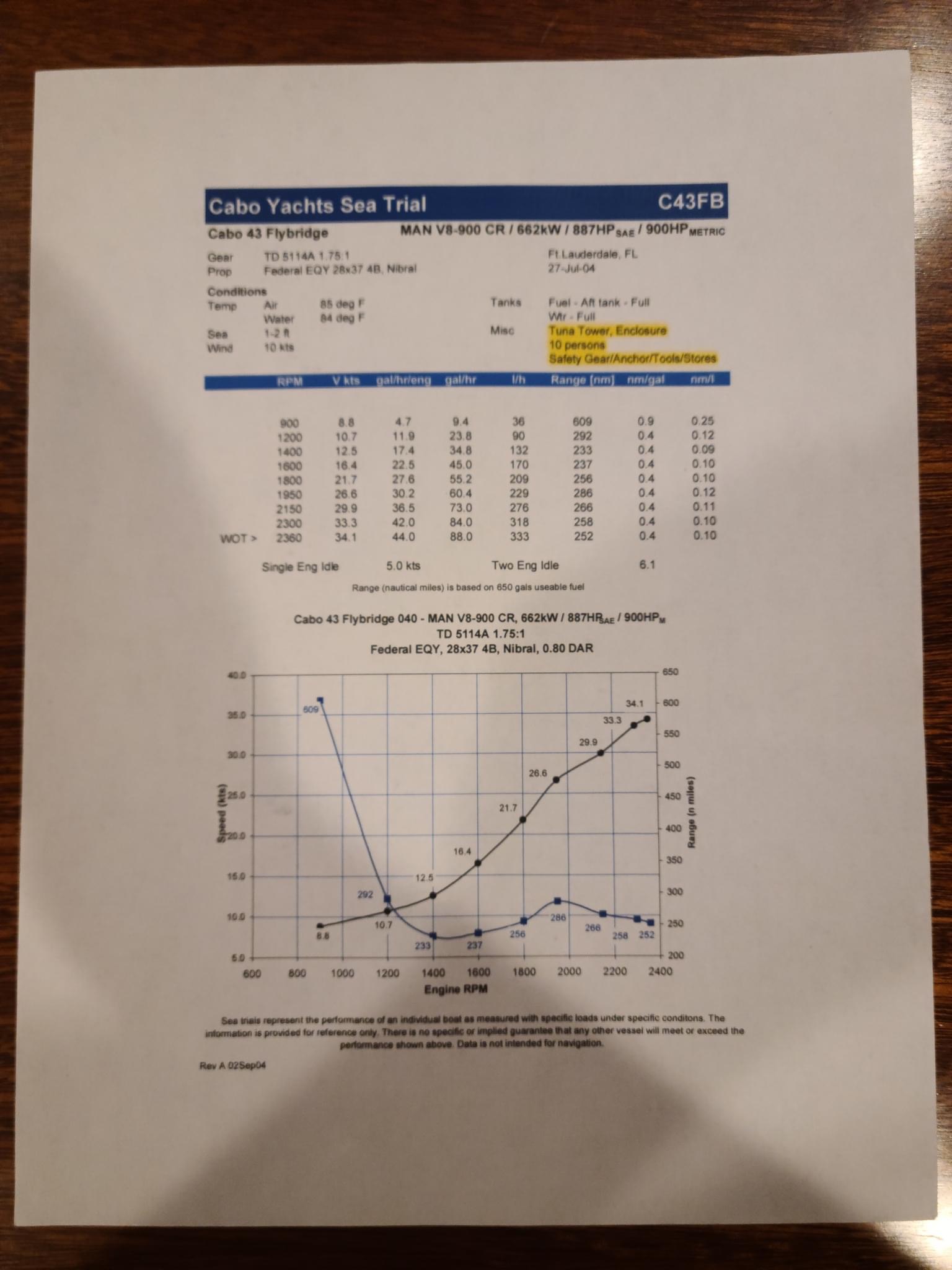

    Does anyone have the Cabo Yachts sea trial sheets for the 43 fly ??
  14. Ben Cooksey
    Ben Cooksey Member
    Oct 10, 2020
    45
    Mobile AL
    Just got it good info
  15. CaboFly
    CaboFly Member
    Aug 24, 2018
    259
    Seattle
    Heck of a Cabo fan to have all those performance reports and brochures in his desk drawer all these years later.

  17. CaboFly
    CaboFly Member
    Aug 24, 2018
    259
    Seattle
    I was just being funny. I posted that pic. :D
