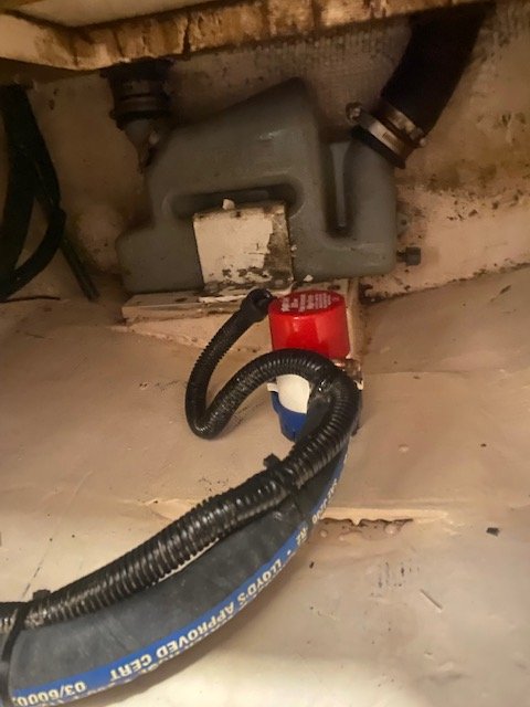

    Though this subject was a few years ago I did look at my generator exhaust configuration on my 2005 Cabo 40 convertible. The generator exhaust discharges via this Vetus waterlock muffler located in the aft bilge area of the engine room directly below the generator. Then the generator exhaust hose runs down the port side above the main engine exhaust and discharges into the port engine main exhaust aft of the muffler.
    Breckster likes this.

    With mine, 2007 40 Cabo it exited port side amidship with the water below on the bottom running surface.
