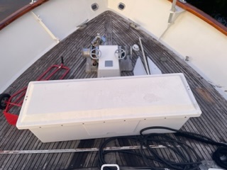

    Well after looking at options for the deck and you folks opinion having much weight as well. As much as I want to keep the teak it is just not feasible to keep it. Im thinking of doing the removing the worn out teak and replacing with Coosa board. I like the Nydacore but I have concerns about puchering it because it is a core product. Am I over thinking this?another issue with the teak is I can't find anyone here in my area(Ft Myers,FL) that will do this and if they can the price makes absolutely no sense. they should use a mask and and a gun when quoting this kind of work.

  7. TGUN
    TGUN Member
    Dec 13, 2021
    43
    florida
  8. TGUN

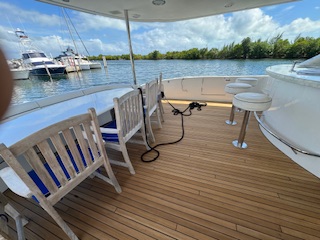

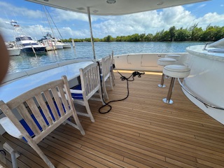

    Thank You. I'm still on the fence about it. However I was quoted 150.00 a square foot installed. I need 533 sq ft by my cal. I have to remove the old teak as well. If you do the math it seems pricey but needs little to no maintenance. Any price comparison would be welcome.
  19. Pascal
    8,950
    $150$ a sqft for the fake stuff? Yikes… we just paid about $110 a foot for the real thing here in Miami.

    Yikes is right!!!! I am looking into the real stuff myself. I'll post the out come. How many square ft is that in the Picture?
