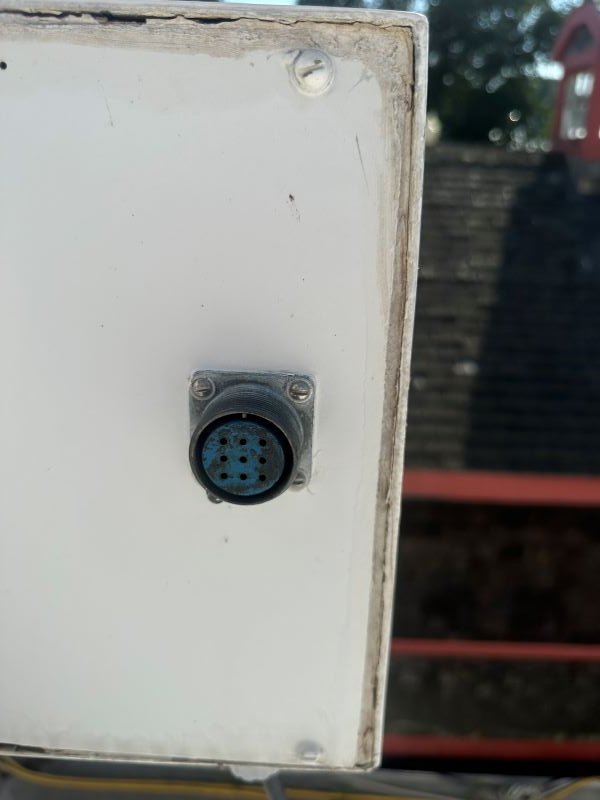

    Question for anyone here running an older Burger - are there any compatible davit/winch replacement controllers out there? The originals are in bad shape and are pretty clunky. Looking for something that will plug into the original outlet on the davit.

    well, depends what you have. Mine is a Marquipt 1500, and obviously they’re still in business for parts etc.

    Yeah, I guess I should have been more descriptive. The two davits are the original ones from the Burger Factory. And here is a photo of the 9 pin connector. Davit electrical hookup 1.jpg

    To my eye the plug appears to be a Marquipt style device. Place a call to Ron at Burger and request any details he may have regarding the original installation. I'm 1980, and the davit is still aboard. Marquipt 1500, referred to at the time as their Tender Lift.
