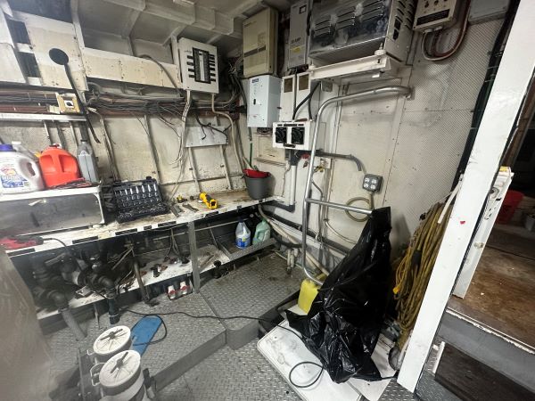

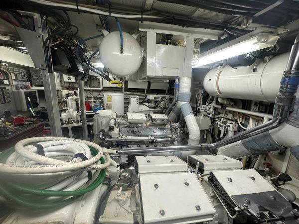

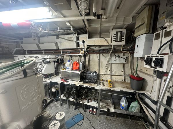

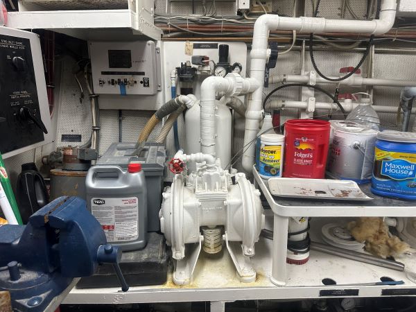

    Ok, a lot to catch up on regarding the feedback you all have given me. So the heads are definitely on an AC powered Air Compressor vacuum generator. Maybe it's not a Vacuflush system. Here are some photos of it all. The Air Compressor also supplies the air horns and compressed air for tools.
    Raritan Elegance - I have one on my 40 footer and it usually has problems each year of some kind. This past year the yard was supposed to winterize it. Well, they said they did but when I got on the boat for the first time, it was cracked. The kids have an innate ability to clog the thing a few times a year, too. ER Port 1.jpg ER Port 1.jpg ER Port 2.jpg Vacuflush 1.jpg ER STBD 1.jpg
