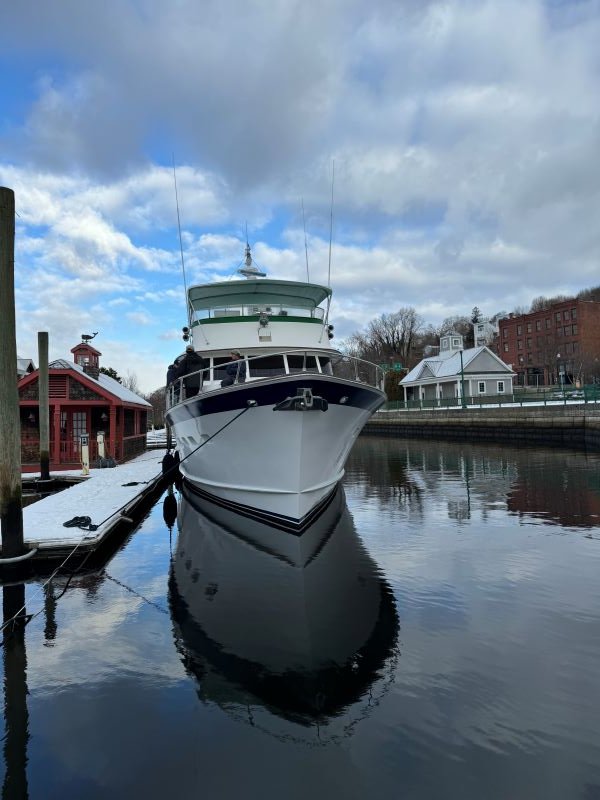

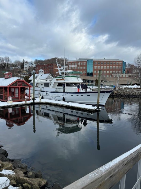

    After a 1500nm she made it. Arrival at The Marina At American Wharf at the head of the Thames River in CT. A bit colder than she's used to, but she's in fresh water and now the refit work can continue in earnest.

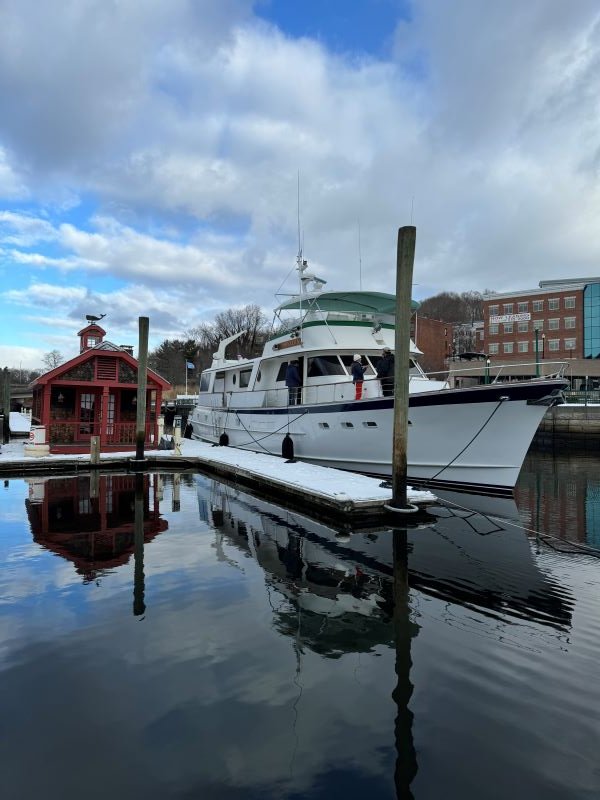

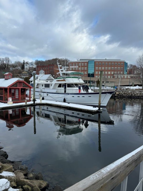

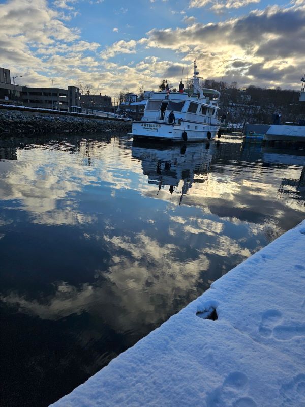

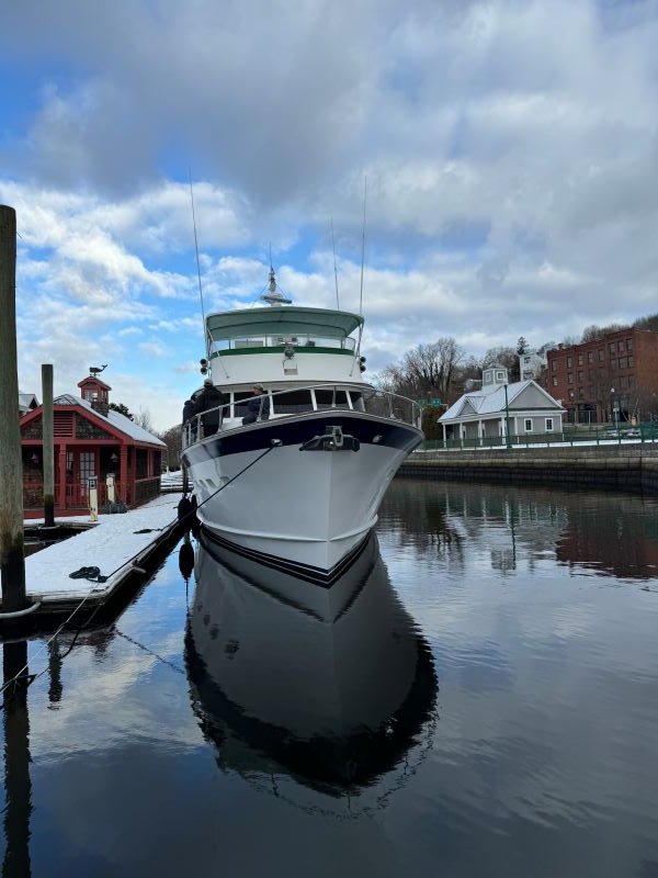

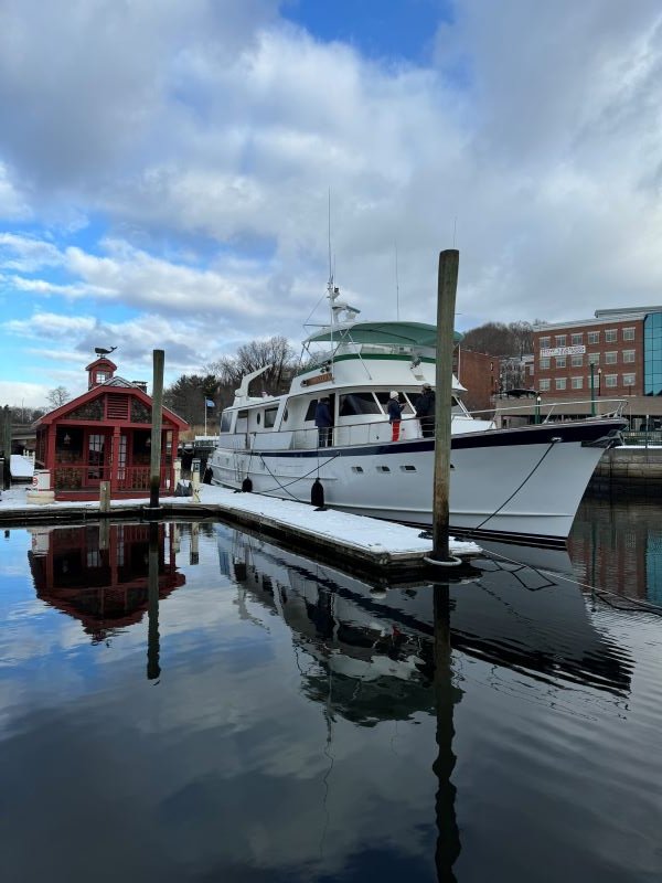

    A few more photos of the arrival.

  12. Capt Ralph
    14,567

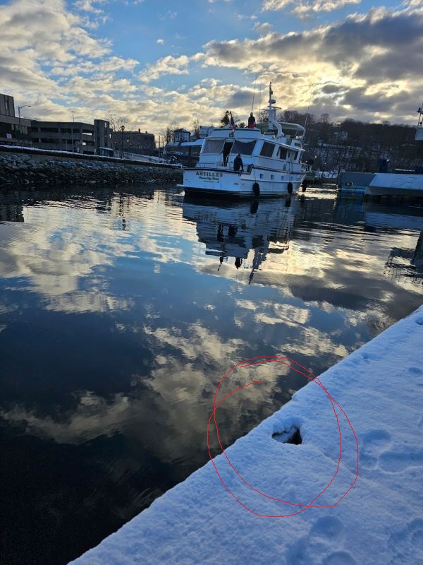

    Strange looking non-skid on the docks. Looks like a spot was missed.
    I fear other leg grabbers are hidden.
    Watch your step??

    That’s snow!
