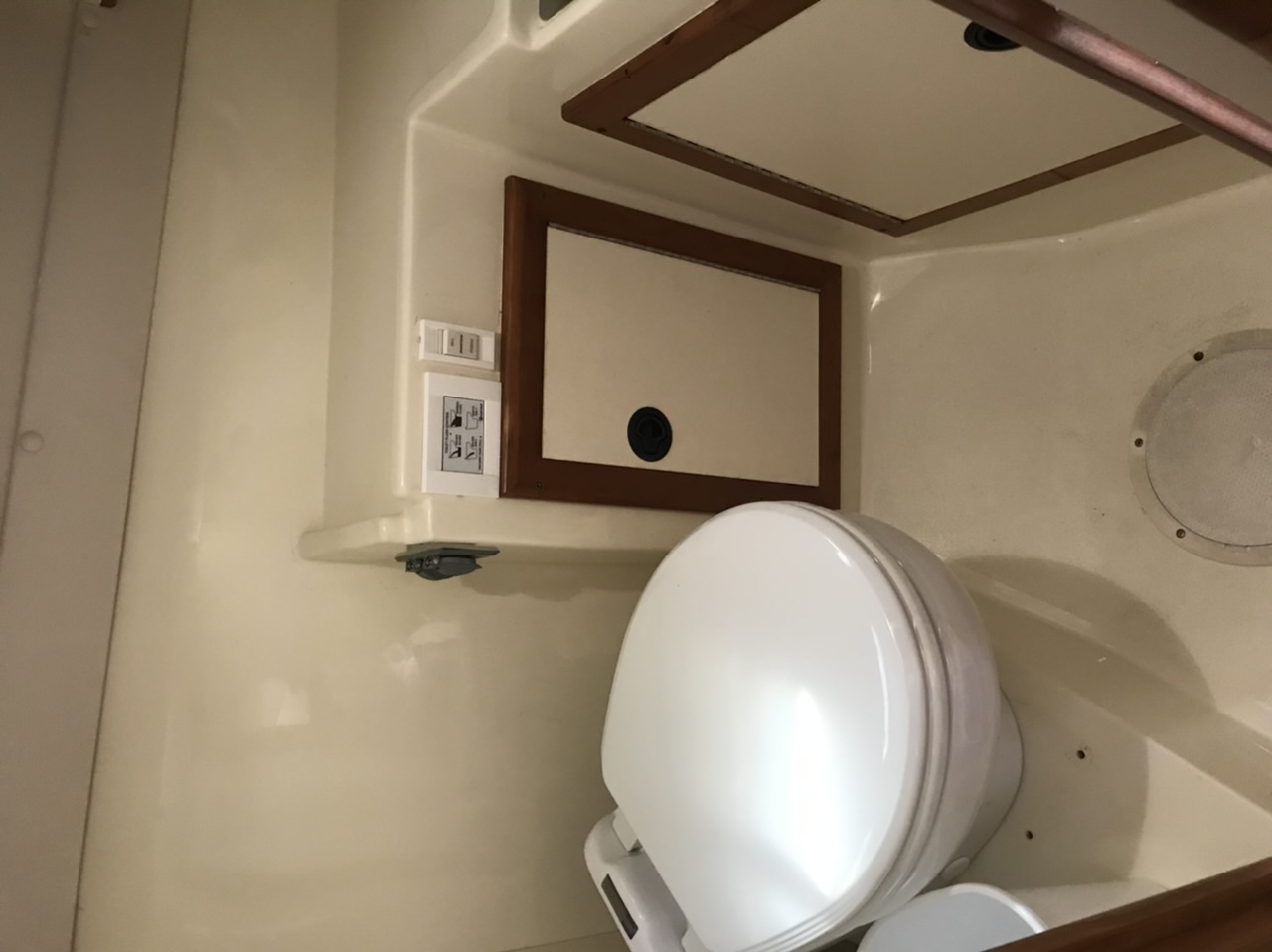

    Regular size Marine Elegance with the “Smart Panel” and the “Salt/Fresh” switch.
    Plenty big enough, and I have a big arse.:cool:
