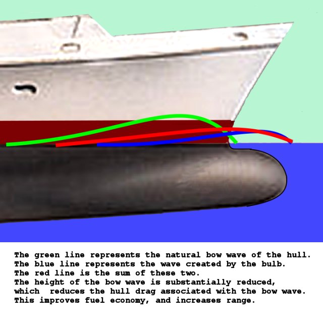

    Wiki's description & illustrations leave a little to be desired too. The illustration below better explains the basic concept, however the shape and size of the bulb plays an equally critical role as well, such as a semi-symmetrical or inverted bulb.

    But the Bulbous bow is not not only about efficiency is it not?! I mean as you said there is a certain hull speed you can compute with the formula 2,42 x √LWL.
    So when you want to go faster than the hull speed you need an bulbous bow to keep the ship balanced (trimming factor). So more horsepower alone does not lead to a higher speed. (?)
  6. Chapstick
    Chapstick Member
    Jul 5, 2011
    93
    Sydney
    A bulbous bow reduces wavemaking resistance, but the increased surface area increases frictional resistance.
    It's only worth fitting one when the net change in resistance is a decrease.
