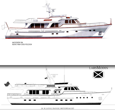

    Thanks Brunick, Lars always giving inspiration and indeed I've shared the development process of the present boat also with him in the past.:)

    I think that the combination of the Moonen shipyard and Rene van der Velden is a good one.
    Since this yacht would have to fill a gap in Moonen’s current portfolio I would suggest a 110’ RPH. A two deck 110’ would look a little overstretched and a tri deck would be too bulky for this length. Moonen also has a history with RPH yachts so it would be quite a natural choice. Maybe the Moonen 105 RPH could pose as a basis for the 110.
    I second Lars’ idea for a motorsailor because I believe that there will be a future for that concept, although I simply can’t picture a Moonen with sails yet. Van der Velden’s Cyrus 3700 is a good example for a new motorsailor. His designs for Cyrus and Nakhimov are quite good but maybe too trendy or retro for a Moonen.
    I like the previously mentioned softness in the Moonen yachts so let’s keep that. Bigger glassed surfaces in the main salon and guest cabins would be a nice touch. They look nice and improve the natural light inside. Personally I’m not a big fan of the (3) vertical port lights in the guest cabins, but that’s a matter of taste. I find them a little outdated. Would balcony’s in the guest rooms be an option? A skylight in the owners’ suite maybe?
    A split level owner’s suite would be nice. (Check the Rodriquez 38 WB for reference). In the aft it would be nice to have lower bulwarks and use a railing instead. This unblocks the view to the water when sitting on the aft deck for, a more “open feeling”
    There was an announcement of the Moonen 110 in Rene’s July newsletter. Is design already on his drawing board?

    Yes, the design is already on his drawing board and seems you have peeked into it:).
    Well, I know it will be a challenge to have a level more and keep it still low in the profile; but it is worth trying. We are looking for good lookout views from the salon and the upper deck and aft deck. Agree there could be a change in the vertical port lights, which Rene already incorporated. Balconies at this size are phony and too complicated to incorporate and they steal valuable interior space.
    Of course a motor sailor is not in the cards, but we are looking what we can incorporate for innovative propulsion solutions, which again should be practical to install and be easy to use and accepted by most owners.

    I also like Lars's style a lot, but as it has been pointed out by some other members, we also seek to follow the general line for Moonen yachts; hence we will stick with the Rene's softer styling, but of course I would be very pleased to incorporate any good idea.

    Maybe Rene vd Velden and Lars must work together on the design of this project, i think you will get a very good design if they have to put their heads together. It could be called the van der Velden Lars design.
  10. AMG
    5,392
    Thanks for suggesting this idea Graham, it would be interesting but not really realistic. Besides, I am not taking on any new projects as long as I am my own "inhouse designer". It is actually more fun to make complete designs than just exterior styling and interiors.
    /Lars

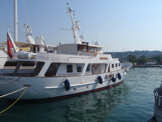

    Bjorn,
    We are very much aware of the restrictions and challenges for a three decker at this length, but a raised pilot house is a big compromise. You do not have a good flybridge and the space below is not good for anything.
    In the past there had been good examples like "Saga", but agree they are somewhat too traditional. We are hoping to come out with something that is also contemporary both in the looks, but most importantly in the use of internal space and flexibility of space planning for different owners' tastes and needs.
    I have recently come across this lovely lady in Corfu, which is much smaller in size, but she looks quite ok to me. I hope you will also share my opinion.
    I believe that most owners around 100-120 feet mark are looking for something that is esthetically nice and space wise properly laid out. If this had not been the case, quite a lot of main stream series builders would not be trying to impose imitations of three deckers as long range sea worthy boats.

    Actually, we have almost done it before. I made a design for a Moonen long time ago and Rene later gave it a twist of his style...

    Hi Nilo,
    This is indeed a very sweet classic. Your explanation cleared the remaining questions I had about the concept. An RPH does indeed create space with limited usability beneath the RPH floor. If you go for maximum efficiency in terms of interior volume, I guess a tri-deck is the optimal solution.
    Are you opting for the traditional white paint job? I kind of like Rene's use of colour schemes on the Cyrus yachts. Also the use of woods in the aft railings look very pretty.
