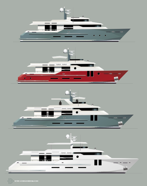

  15. AMG
    5,392
    Perhaps you remember that I posted a concept to be built near you last year. It never happened, but instead of lining my computer I can post some of the drawings leading up to the final 100-footer.
    The idea from the shipyard was to use the lines from this older design; http://www.yachtforums.com/forums/17107-post119.html and make it more of an Explorer and also with the master cabin forward, raised above the sea level.
    So here they are, 85´to 100´:

    Thanks, indeed we are also working on a design more or less in the same lines; however I think a pilot house on the top deck may be something good. Of course the dilemma is how to make it still a low and sleek boat in the profile.
    When we move the pilot house to the top deck, then we may have the fore part of the main deck either for the dinning area or a master cabin at deck level.
    There could be 3 guest cabins on the lower deck and there would be 2 crew cabins with bunks + captain's cabin at the fore part, which will have a separate entrance from the galley on the main deck.
    This would leave a large lazarette at the aft, which can also house the main tender.

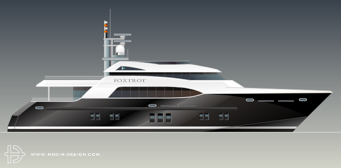

  20. AMG
    5,392
    Thanks Jannick, this is a 110-footer with a raised wheelhouse. (From 2004)
