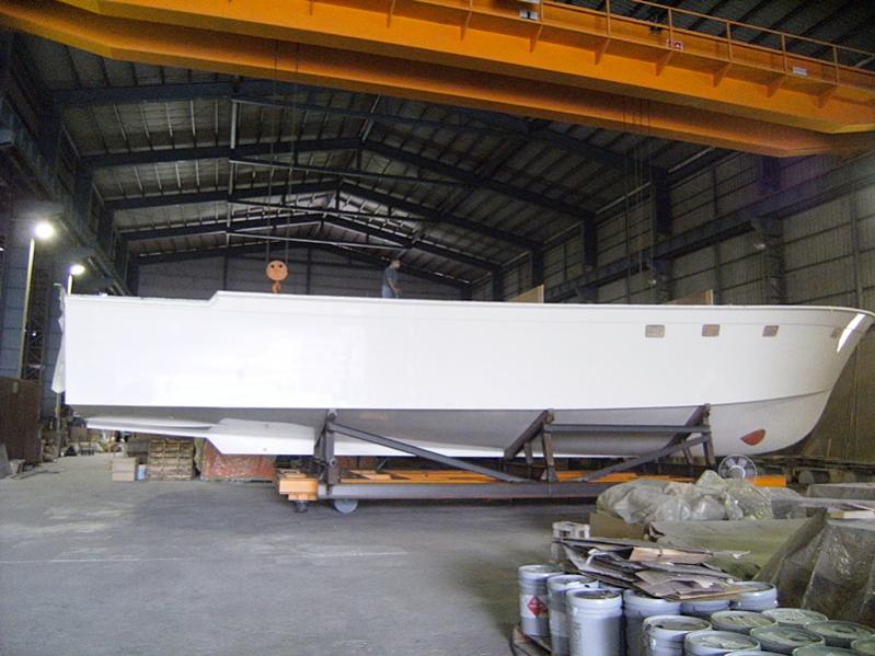

    We are building a new 2013 62' Offshore Pilothouse M/Y "Many Waters" this pic shows the hull out of the mold and gel coated for Hull #98. Lots of fun decisions and tweaks going on between us and the builder / factory as we finalize all of the interior decisions. Enjoying the research on all of the great new electronics and functionality from our last yacht in 2008.
    We have twin Cat- C12's, ZF Drives and the joystick maneuvering system with I Anchor that we can't wait to use and enjoy and hydraulic bow & stern thrusters which will be a treat. We are taking the best of what we like from 6 other 62' Offshore's that we have been on and want to thank the owners for allowing us to see their beautiful yachts to get ideas.
    It has been great working with the Offshore Team and vendors providing us quotes and appreciate their flexibility. Hope to be at the Miami Boat Show and cruising Many Waters on the east coast next spring!
    More pics to follow if this of interest to the group and thinking of starting a blog on the build process.

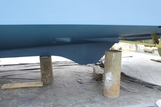

    Not to be critical, but I would like my keel a little deeper to protect the running gear as much as practical, specially in the PNW waters.
    Good luck on the project, will be exciting.

    Thanx, one of the trade offs you go through, but we will based in FL. and be in plenty of shallow waters from the Caribbean to the ICW and many other waters, we wanted to be just under 5' draft and a low center of gravity. Maybe someday we will do the Panama Cannel and The Big U the other direction (great book by the way), as that is on the bucket list.

    As dennismc commented, looks like you have made the keel shallower? How will this affect handling in following seas etc.? Mine was good in all seas.

    The keel, I had to go back and look at the pictures to figure this out and what I believe to be the case is that there is a keel extension that is added in front of the prop pockets, possibly designed to break away and sacrifice? That was the design of our previous boat and looking at the two pictures it would seem to be the case here. I will follow up on that further as we do have a 5' draft and the finished picture shows the full keel.

    Keel
    Here is a pic of the finished keel on a different 62' Offshore. Bottom of the keel is 5' bottom of props is 4' 8" is what I find on the standard specs.

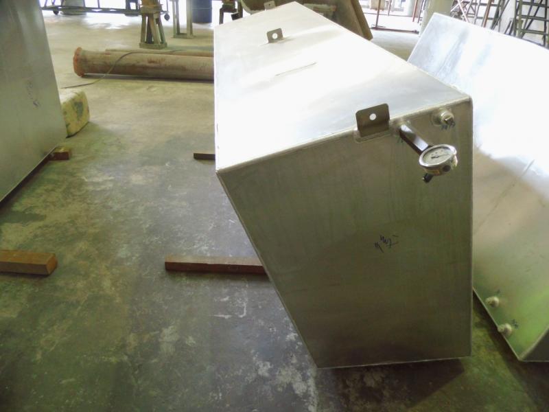

    Pressure testing the fuel tanks
    3 fuels tanks holding 1,000 gals under going pressure tests over the weekend. We are also planning a Maretron monitoring system for all tanks, main engines, hydraulics, fuel management, temp's, water pressure, bilges, security and remote monitoring, and a handful of other monitoring points. We saw this system on another Offshore and was impressed with it's capabilities and the peace of mind it will offer us while cruising as well as the times we are away.
    Let's hope the tanks held the pressure tests!
  10. Capt J
    14,641
    Why are they using metal fuel tanks? Most Tiawanese builder's are fiberglassing fuel tanks into the hull from what I've seen in the last decade.....

    Chicago
    Fuel tanks
    I honestly don't know about most Taiwan builders, the Offshore has 3 aluminum tanks, epoxy painted and interconnected with cross feed lines and very large and accessible clean outs for the tanks. Water tanks are stainless steel and the grey / black holding tanks are molded into the hull.

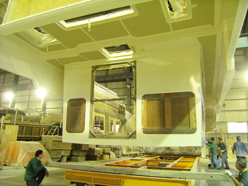

    Main deck comes out of the mold
    Yesterday the main deck came out of the new mold. Offshore retooled their molds back in 2009 (I believe) and the new tooling adds flush leakproof windows, doors and hatches, higher bulwarks on the bow, a non-skid to the PH roof with a slightly different profile I believe and a larger molded helm station on the FB to accommodate the electronics, among other things.
