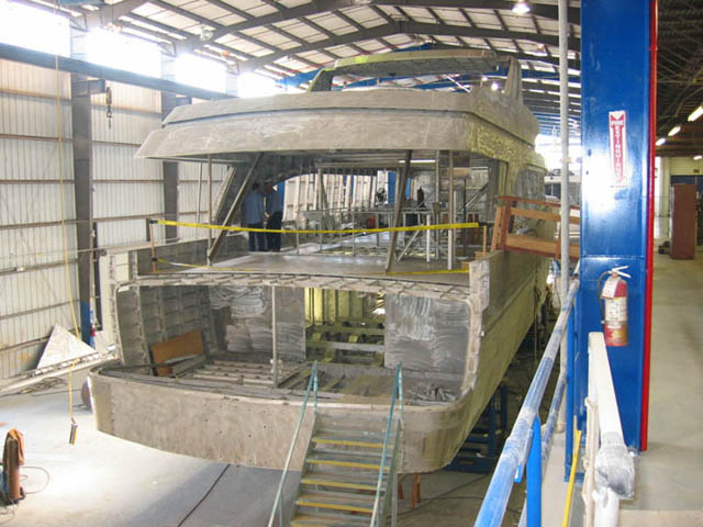

    Approaching the structure from the 3rd level of Broward's shed, the 120's boarding ladder isn't quite as fancy as those found transversing the docks at Bahia Mar... but it works equally as well.

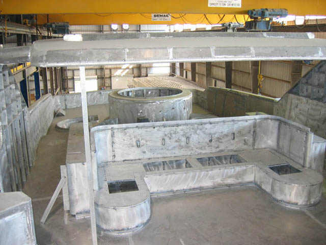

    As we walk closer to the structure, you begin to get a feel for the enormous amount of labor still ahead. These are the preliminary stages of welding, grinding and shaping... and repeat as needed.

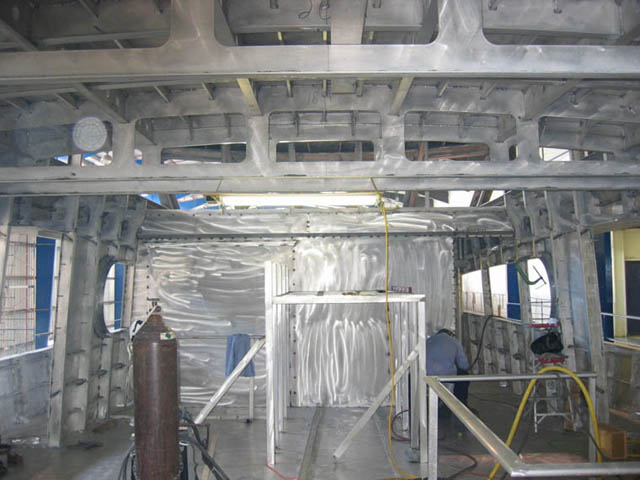

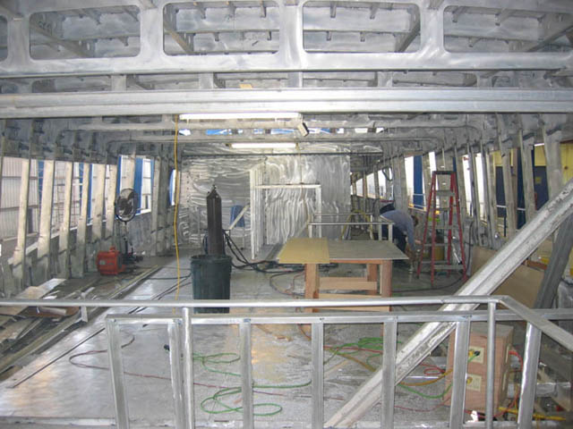

    Standing on the aft deck, looking forward into the salon. Notice the railings in the foreground? The next picture is the reason...
  4. YachtForums
    20,375

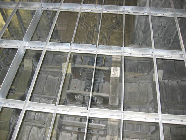

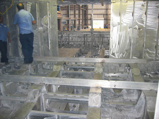

    Immediately beneath our feet and surrounded by the railing is a temporary grid to protect workers from falling into the engine room below. This cut-out is purposely left open to allow the engines to be dropped in after the basic structure is completed. If you study the picture closely, you can see the raised sections on the main stringers that will become the engine mounts.
  5. YachtForums
    20,375

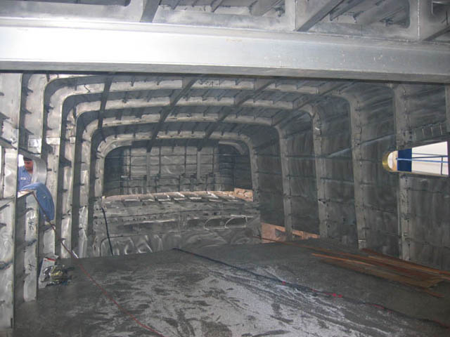

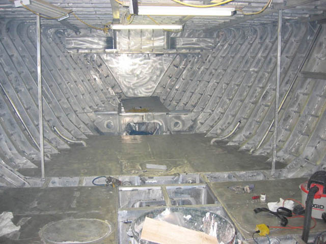

    Here's a better angle on the engine mounts, taken from within the engine room. The horizontal beams are only temporary, as are many pieces at this time.

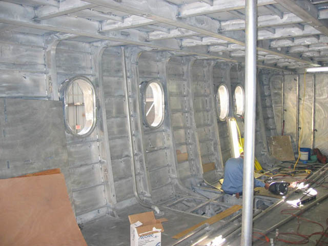

    Going below to the lower deck, these portholes will illuminate the guest suites...

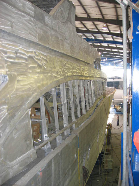

    Moving forward, the bow appears to be built well enough to break ice...

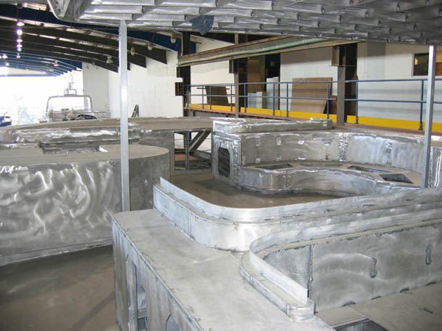

    Exiting the caverns of the lower deck and going three flights up, this picture is looking forward over the whirlpool that will no doubt be the center of attraction when a guests looses her inhibition.

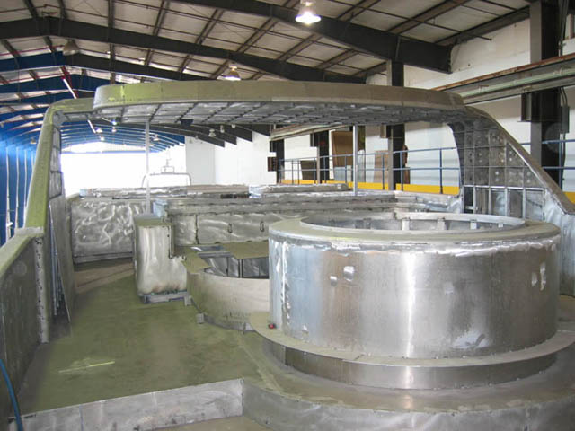

    A few steps forward of the whirlpool, the seating (which was previously finished) has been welded to the decks and the flybridge helm is beginning to take shape.

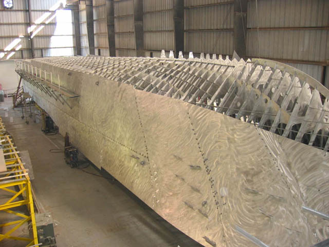

    But wait... there's more! Hull #2 is beginning to take shape directly behind hull #1. Henry Ford would have been proud. Thanks to everyone at Broward for allowing us to witness a lot of hard work, from behind our keyboards.

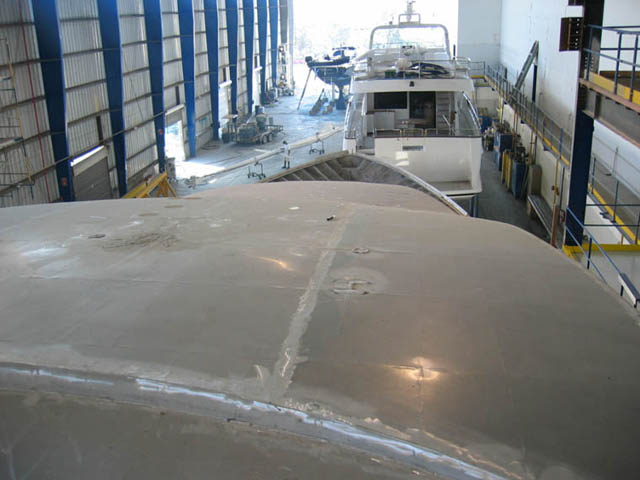

    Thank you for the wonderful pictures. I am glad to see Broward on the come back. The Vessel in fron of the Broward 120 is that a new construction or refit.

    I don't recall what it was. It's not unusual for a refit or repair boat to be under the shed, in addition to boats under construction. This is an integral part of Broward's business. On any given visit to the yard, you'll see a few distinguished yachts at their docks, but... due to the recent hurricanes, most of those docks are MIA. The docks are scheduled to be rebuilt soon.
    When Mac logs on, he can tell you what the boat was in front of the 120'. Although, they're getting ready for Miami right now, so it may be a little while.
  18. MacMcL
    MacMcL Senior Member
    Jul 20, 2005
    54
    Dania Beach
    Hi Carl,
    The vessel in question is a Hakvoort, build in a Dutch yard of the same name. Your are correct, in that it was in for top to bottom paint job.
