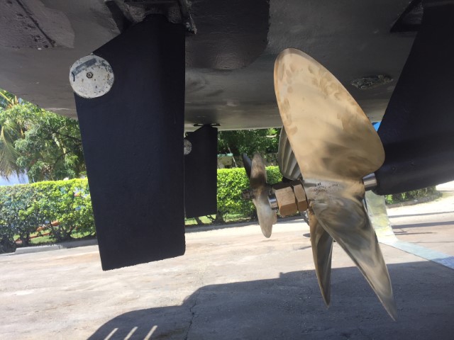

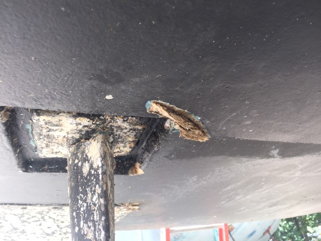

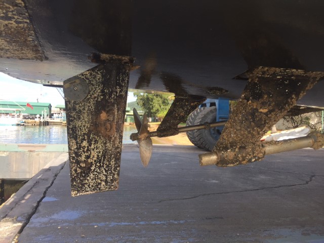

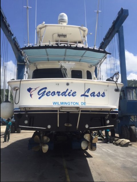

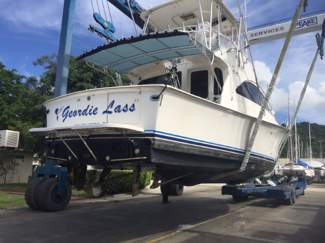

    Some pics from the job

    Hard to tell from the picture angles , the design target for the distance between the Forward Face of the Prop Hub and the Aft Face of the Strut Barrel is usually kept to 1.0 x Shaft Diameter or less. I typically try to aim for 0.5 x Shaft Diameter. Just something to keep in mind for the future.

    You are correct on that, the new shaft was shorter than the old one, which we thought was an issue at first, but it appears that it is the other way around. we measure and it is just about 1 " from the hub to the aft face of the strut, which is just about right for the 2" diameter shaft. next haul out, I might look at pulling out and shortening the port shaft to reduce the "whip"
