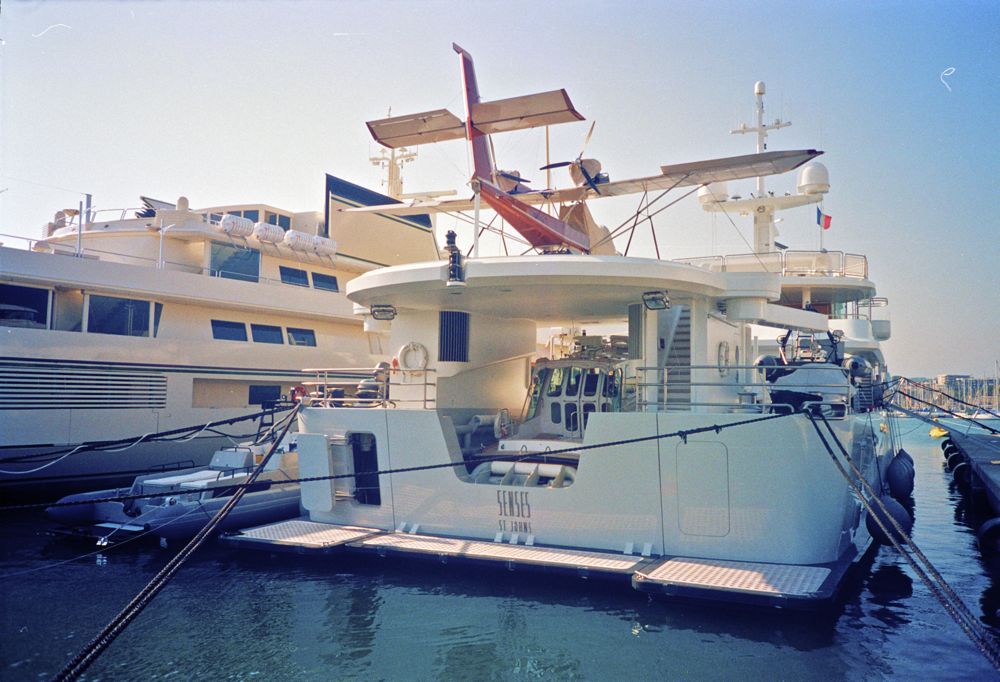

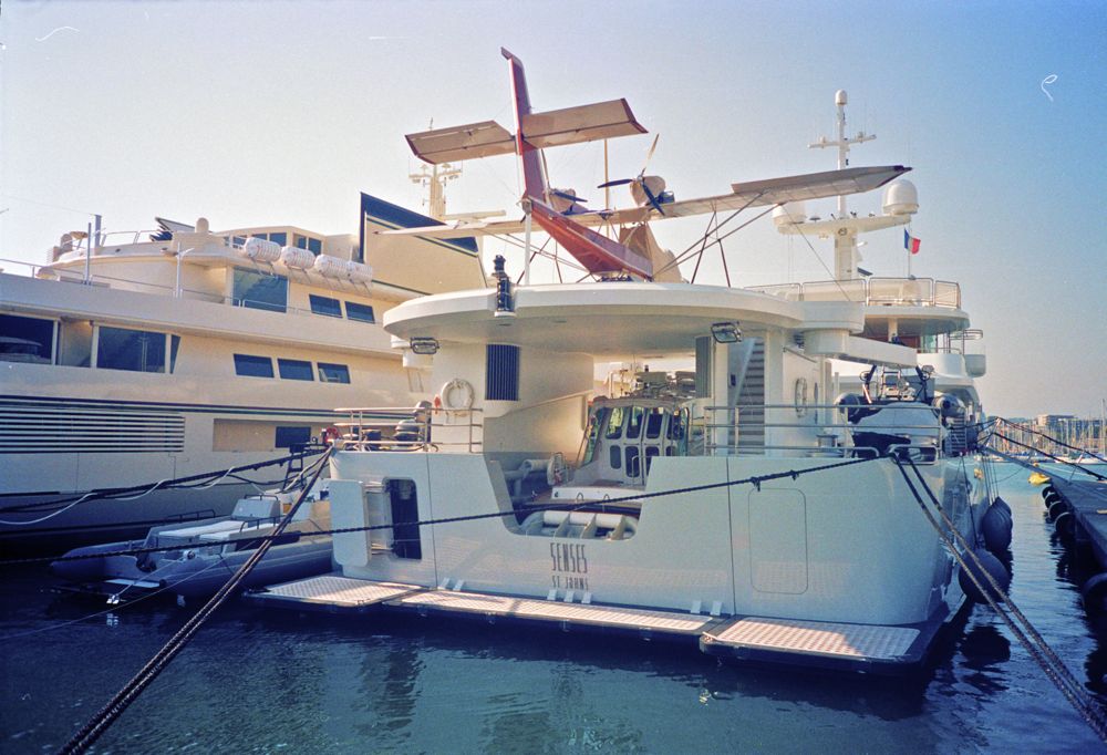

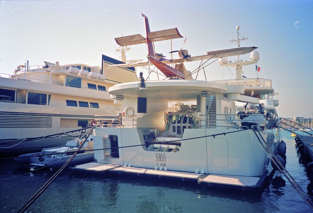

    Since you are mentioning Senses, I just today did a scanning of some old pictures I had on her...

    Lars thanks for the picture, by the way hope all is good with you..
    As it is seen here, the tender garage arrangement also takes the space from the yacht. In fact, the engine rooms was also very large and there were only two corridors coming aft at the aft section of the hull...

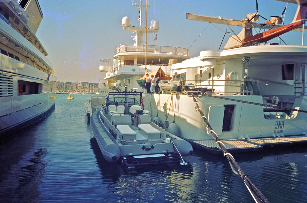

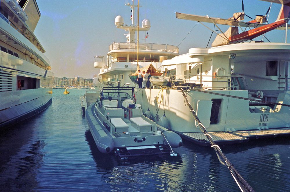

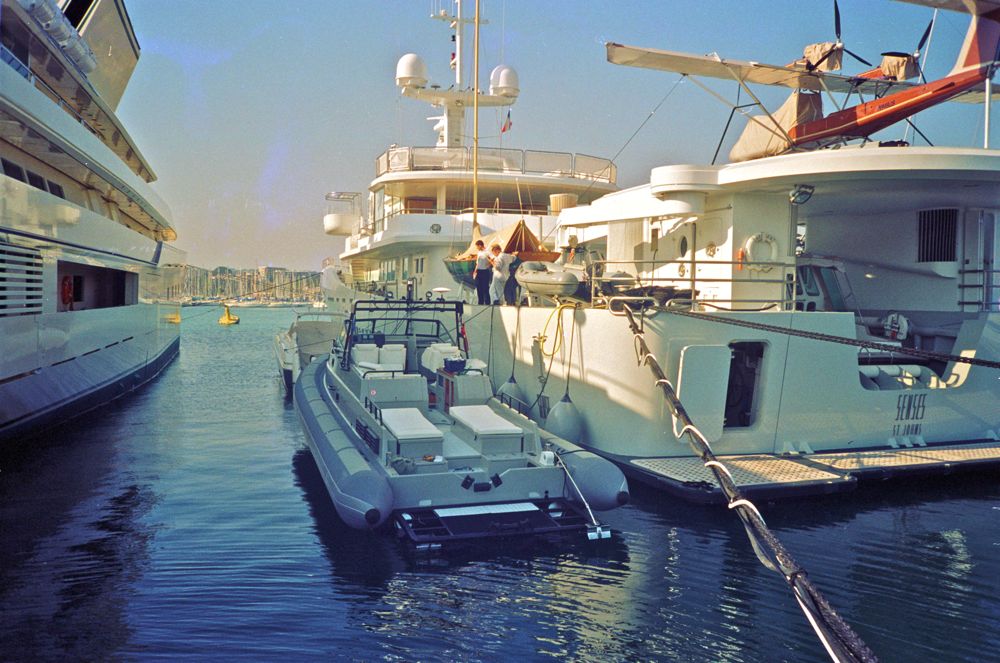

    Thanks Nilo, all is well with me. Here is another picture where you can see the sail boat on deck....

    I think the large inflatable tender also belongs to the yacht and was positioned on the starboard side opposite to the sailboat.
