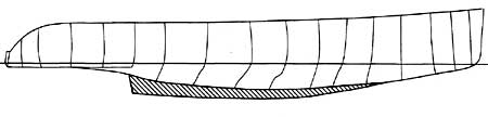

    I think the idea of making a hull shape for a certain cruising speed is the good news. The shape itself is seen before, more or less, even a waverider I had was with that concave surface in the back.
    Many hulls today carries too much weight, compensated by too much power, which makes them both less seaworthy and less economical.
    The rising fuel prices will probably make us develope better hulls, especially hulls that perform well at a given cruising speed.
    The Beachboat is a good example.
  4. YachtForums
    20,694

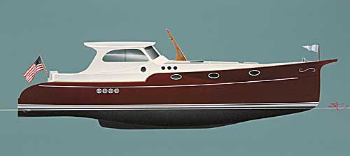

    There was never any form of PWC or jet-ski using a concave hull. It would not work with a jet pump. You may be thinking of a cathedral hull used on Kawasakis, such as the 440, 550, 650 or X-2. This had longitudinal concave sections at each chine, which were designed to add grip in a banking turn.
    The Beachboat features a reverse deadrise hull toward the transom. This is actually a unique design. It could effectively produce displacement-hull efficiency, but still have the ability to achieve plane. At displacement speeds, it should offer more stability than a traditional trawler hull form, due to the broad aft planing surface. At planing speeds, the shallow round section of the forward hull should not displace water outwards enough to negate the ability of the concave section to encapsulate water and channel it under the rear of the hull. Theoretically, the rear of the hull could benefit from the surge created by the bow, adding lift and trim. I think this shape actually works quite well with the natural flow of water.
    My only concern would be... I believe this design may be subject to broaching in a following sea. Other than that... it's a design worthy of development.
  5. YachtForums
    20,694
    Theoretically, the Beachboat could have some surface effect properties toward the transom, IF... this is an encapsulated area (hard to tell from the renderings). Surface Effect Vessels are shallow draft hull designs, that are capable of carrying heavy loads by encapsulating and forcing air to travel under the hull. It essentially creates an air-cushion. There is great merit to this design and has been the subject of much research by the Department of the Navy, but it's rough water capability (at speed) is questionable.
    The hull looks like a barge, but how the hull interacts with water at planing speeds is quite different from a barge. Air is allowed to pass under the hull and become compressed between the hull and the water's surface, eventually being forced to pass under the submerged sections of hull and exit at the rear. This creates an air cushion and a dramatic reduction in drag. Somewhat similiar to a hovercraft.

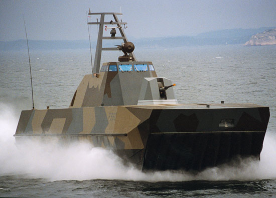

    Here's an example of a Surface Effect Ship...

  9. YachtForums
    20,694
    In essence, any kind of high speed cat or tunnel could be referred to as a surface effect vehicle. You could also call a cat a reverse deadrise hull, but in reality (with offshore cats) it's more or less a deep-v, cut in half, creating "sponsons" that are connected by a lifting section. You might refer to this section as a wing, but it doesn't really have the same properties as airplane wing which developes lift by positive pressure under the wing and negative pressure above.
    A more appropriate term for the type of craft we're discussing would be a "compression & aeration hull". That being said... most high speed cats work on the same principles! The volumetric area within the tunnel decreases towards the rear of the hull, creating a "compression", thus developing lift. As for the "aeration" part of this combo, it takes place due to ventilation steps on the bottom of the sponsons. This helps break surface tension, thus reducing drag. Essentially, we're discussing different types of surface effect vehicles.
    There is a point at which a catamaran coming on-plane acts exactly like the surface effect vehicles were referring to. It's called "tunnel sneeze". This is when the air in the tunnel is being forced back (as speed increases), but the sponsons have not fully developed hydrodynamic lift yet. The result is, the air is compressing and has no where to go, (it can't escape out the rear yet) so pressure builds and finally releases forward and over the bow. It's generally a fine mist of spray that requires cleaning your goggles. It's a major pain with cats.

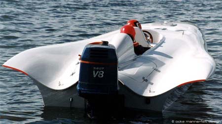

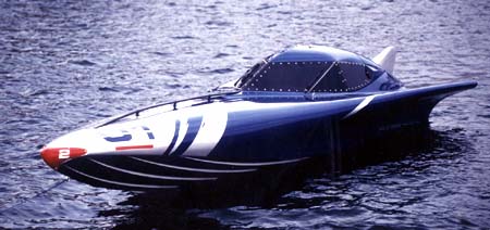

    I thought I might contribute to this thread. I have been a fan of Ocke Mannerfelt for quite some time now...having even built some of his V-24 and B-28 batboats under the name Armada. But this boat pictured is my absolute favorite design of his...as you can see it is very advanced and state-of-the-art. Ocke is from Stockholm, Sweden...where gas prices are insanely high compaired to here in the US so even his raceboats are designed with fuel economy in mind.
    One of our B-28 batboats equipped with a Volvo Penta HP525DPX-HP (engine built by Innovation Marine with 525 horsepower) would run 86 miles per hour (not completely dialed in might I add) and was achieving 3.3 mpg at WOT...three times the industry average...now, not only is that fast and very economical but the boat can run those speeds in 6' + seas with no problem and very safely.
    I would love to own this boat featured below, it is a one-off design of Ocke's that I don't have a lot of information on. Looking closely you can see it is a stepped hull design with all the strakes running straight into the bow instead of turning into the keep toward the front...I believe this design makes far more sense than the other as it helps the boat follow into a turn and also creates additional lift through their shape. The steps help to introduce air under the hull which reduces the wetted surface...the boat actually rides on millions of air bubbles like ball bearings making the running surface much more efficient. Too much air detracts from handling and can make a boat dangerous...not enough air and the benefits aren't realized. You really need to understand the running surface and what's going on between the hull and the water.

  13. YachtForums
    20,694
    As we are talking about surface effect or in-ground effect vehicles, it is very appropriate to include Ocke Mannerfelt in this thread. While the "Bat Boats" are purpose-built race boats, there is much than can be learned from some of Ocke's revolutionary hydrodynamic development.
    If I remember correctly (it's been a few years), Ocke was originally an engineer for Volvo-Penta, before starting his own design bureau. Among his other notable inventions were "Speed Rails", which were aftermarket appendages that could be added to strakes, essentially creating a reversed strake concept. Their purpose was to capture water being displaced outwards and channel it backwards, thus increasing lift... and ultimately speed. THIS is *applied* hydrodynamics. ;)
    However, Ocke gives equal consideration to aerodynamics, as evidenced by his B-28 & 24... "winged wonders", as we affectionately referred to them. These designs are another example of surface effect (in aviation, this is referred to as "In-Ground Effect"). With Ocke's Bat Boat's, the line is blurred... are they surface effect or ground effect? Ultimately, it makes no difference. It's the same concept... on different surfaces (water or ground).
    The Bat Boats take advantage of the useful aspects of ground effect. The wings not only generate aerodynamic lift, they also add lateral stability at high speed. Stability is accomplished by pressure differentials on each side of the boat, or wings in this case. The wings are creating lift (at sufficient speed ofcourse) that increases or decreases as the wings move closer or further away from the surface (laterally). The result is a dramatic decrease in chine-walking for a v-hull at high speed.
    Better explained... if the hull chinewalks, or encounters a lateral oscillation, the falling wing (or side of the boat) encounters greater lift do to the compression of ground effect, while the rising wing receives less pressure. They effectively balance each other out.
    The Bat Boat's have great merit in a high speed, v-hull design, but they have one major draw back... how to dock the darn things! :rolleyes: Quite simply, they don't mate-up well to docks, but of course they are easily suspended between pilings.
    The ride on a Boat Boat is similar to a cat at higher speeds... you truly feel the lift and cushion effect. In certain offshore conditions, it is a better ride, as would be expected with a v-hull. Still... stability favors the catamaran hull. But when it comes to a TRUE drivers boat... I doubt anything can compare. This hull reacts VERY appropriately to trim, throttle and steering (unlike a cat!). If I had my choice for an offshore wavejumping playboat... I would choose one that is challenging to drive and forgiving at the same time. Ocke's B-28 would top my list! Seriously fun boat!! :)
  14. YachtForums
    20,694

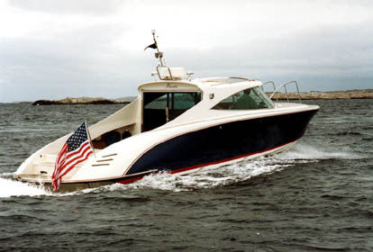

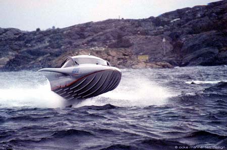

    I've included a couple of images of the B-24 & B-28's for reference purposes. The first image is the B-24 (24 feet) at idle. The next image best conveys the content of this thread... surface effect! The last image shows the wings in greater detail.

    Your explanation is correct in how the wings create exceptional "balance" when running at speed and helping to keep the stability of the boat. As stated earlier they were specifically designed with the Volvo Penta duoprop in mind...when things get a little crazy you can simply "wiggle" the steering wheel back and forth slightly and the drive will help to recover any "loose" conditions...aiding the wings.
    What you didnt' mention that I find amazing is that when out running hard in offshore conditions...you will always find that rogue wave or "ghost wave" as I like to call them...they typically launch a V-hull boat to the moon dropping the transom as the bow goes to the sky. What's great about the batboats is that they have very little frontal area (they're skinny up front) and don't catch a lot of air...the rear is wide and tends to hold the air well...so they fly extremely level...even off of steep ghost waves.

    You're absolutely right about the wings inducing trim into the hull. The B-28 *does* fly straight and level off waves. The narrow bow, coupled with an abundant surface area under the wings quickly negates bow rise when launching off waves, by adding lift at the transom. The narrow hull (needle-nose) form of the bow offers very little resistence to wind velocity in comparison to the aft section, as the angle of the hull increases relative to the waterline. However, this was one aspect of the design that was not as appealing to me and therefore I didn't elaborate on it. Let me explain...
    In a worst case scenario, this is one of the few V-hull craft that "could" be prone to a high speed stuff. It's very simple math. Increased lift at the transom coupled with a lack of displacement/girth at the bow can result in an unwanted catamaran-like characteristic. Newer style cats, with increased sponson girth don't suffer the same effects to the magnitude of older cats, such as the 24' Skater back in the 1980's, which lacked sufficient bouyancy at the forward sponsons to offset wave penetration.
    In the case of the B-28, the trim induced by the wings is quite pronounced, as it keeps the boat very level. A little too level for my taste (this is personal). It is remeniscent of Harry Schoell's Duo Delta Conical Hull (or DDC), which utilizes a single step, located at midship, to create a wave surge at the transom. This design is VERY effective at inducing negative trim into the bow. However this hull will never completely "air-out" and runs with a fair amount of wetted surface. (no matter what Pat's propoganda is for Active Thunder powerboats!) The hull simply does not work well for offshore conditions and it is even worse on smooth water.
