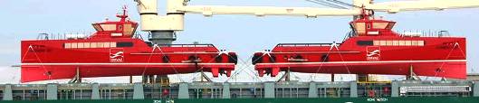

    AXE Bow Concept performance.
    Well, you raised such a good point, naval architects studied it:
    Abstract
    In an earlier paper the first two authors presented the results, which they obtained from a desk study on the influence of a rather pronounced bow shape modification on the seakeeping behavior of a fast patrol boat. This bow shape modification (the so called AXE bow) became possible after applying the Enlarged Ship Concept on a 26 meter length over all patrol boat and was first introduced by the first two authors in 1995.
    In this paper the results of extensive towing tank measurements with the AXE Bow model and the same model with a conventional bow are presented and compared. These model tests have been carried out in the Delft Shiphydromechanics Laboratory. Tests have been carried out in calm water to measure the calm water resistance, the sinkage and the trim of the designs. In addition ship motion measurements have been carried out, primarily in head waves conditions, which were aimed at a validation of the computational results as presented in the previous paper, which were obtained from calculations with the nonlinear code “FASTSHIP”. In addition a number of numerical simulations have been carried out with these two designs in moderate to high stern quartering sea states using the nonlinear code “FREDYN” of MARIN. Aim of these calculations was to compare both designs with respect to their motions in following waves
    (not available during the tests) and on their possible sensitivity for the broaching phenomenon and/or heavy rolling in those conditions.
    The results of these tests and calculations and the comparisons between the two designs are presented and discussed in this report.
    Associate professor,
    Delft Shiphydromechanics Department, Delft University of Technology
    Assistant professor, Delft Shiphydromechanics Department, Delft University of Technology
    Project manager, Maritime Research Institute Netherlands MARIN.
    The complete study is available here:
    http://www.marin.nl/web/show/id=45009/contentid=601
    Yachtforums has another thread which highlights the design as well:
    http://www.yachtforums.com/forums/f...re-concept-sabdes-50m-axe-bow-superyacht.html
    Credit for the 'Axe Bow': a high, straight bow shaped like an axe, of course goes to maritime engineer Dr. Lex Keuning, who came up with it in the 1990s.
    They shared your concerns, but it turns out that the extra lift derived from the added displacement up front effectively "counters" any tendency to "dig" in :
    http://www.tudelft.nl/live/pagina.jsp?id=d0eecab7-8ba3-4ef6-840c-b69a37be7b31&lang=en
