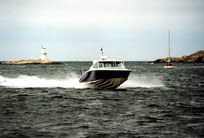

    Very good looking boat!!! Can someone explain the "rising" hand-rails on the bow? :confused:
  2. AMG
    5,392
    This boat was built for a guy living ten minutes from me. I have never seen it go faster than on the picture, but there are a couple of sister-boats with "normal" transoms and they are pretty fast and seems to go well. The shape of the double "sharkfins" on the fore deck are most likely to follow up the overall design theme.

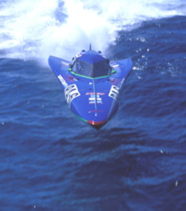

    Running Shot
    It really lifts up...the hull design is impressive to say the least...very beautiful boat in my opinion.

    Zero Cavity
    This is Zero Cavity which was owned and driven by Dr. Santiago, a dentist in Florida...he spent a lot of time and money dialing this boat in and ran it in the One Design Series briefly before jumping over to the Performance Class...the boat simply flies!
  7. YachtForums
    20,941
    Now that's a "Wing In Ground Effect" vehicle! Nice shot. :)

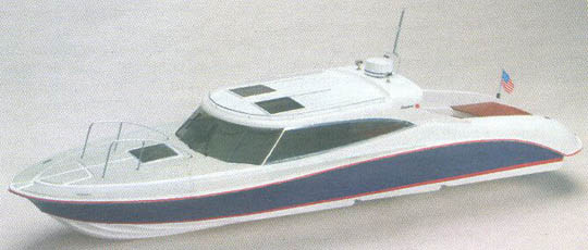

    Mr. Offshore...
    You will be happy to hear, your boat is available! However, it's somewhat smaller than the original production version. ;) This model is being manufactured by Graupner. It is 930mm long and it's remote control. Graupner is a leading manufacturer of remote control models and this boat represents the 2nd model they have produced of an Ocke Mannerfelt design. (the first being the B-28)
    A big thank you to YachtForums member "PromoceanModels", for sending me this picture to pass along to you. Enjoy!

    In studying the model from Graupner posted ealier in the thread... I see a deck hatch in between the rails. Now it is clear why the rails "rise" forward from the deck... they double as a handrail to enter or exit the hatch, as well as a lifeline that doesn't need to be hurdled when docking. Good idea!
