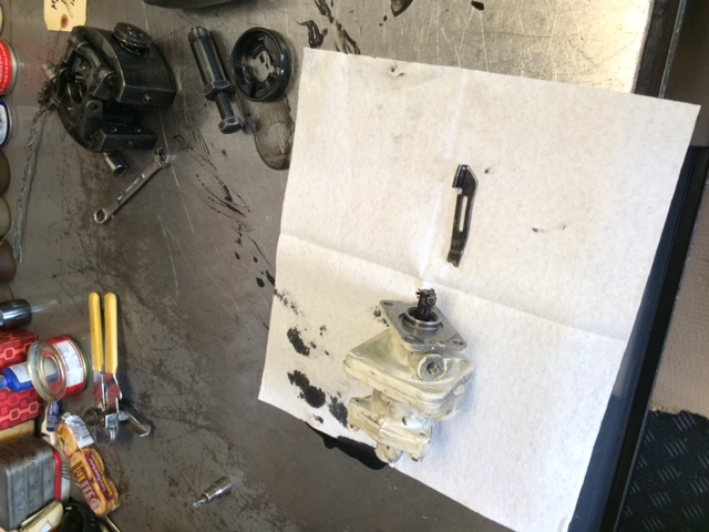

    For everyone who responded here is the photo taken at rpm showing that the full load stop in the intermediate governor housing broke and was loose and moving around in the housing and probably caused the jam and over speed. No other problem was found.

    Sorry wrong photo

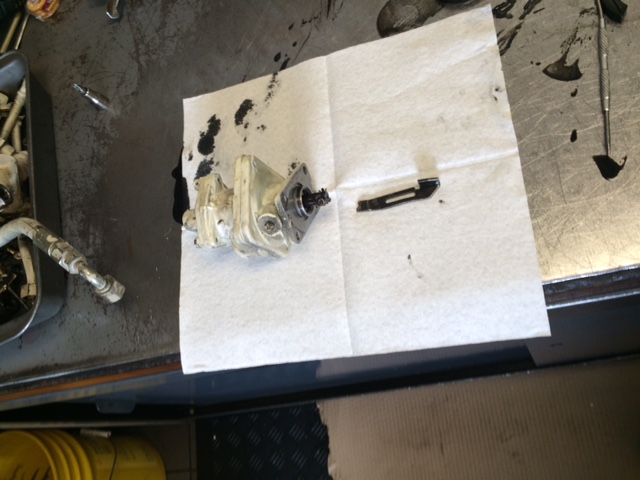

    Interesting. Have you talked to your insurer about this? It seems like the casualty was not a "normal wear and tear" issue but a catastrophic event due to (rare?) material failure. Ask the shop to document the manufacturer's recommended replacement time for the part that broke (that should be fun) and ask them how many similar failures have occurred. This may be well worth pursuing an insurance claim.

    RPM issued a report noting the failure and stating may have possibly been due to fatigue because of age of engine and hours of service, and confirmed no other cause found. I argued and proved low hours (1045) thru three surveys over the years. Also got them to admit that the broken arm is not a serviceable part and they have never seen this failure before, Ever! My insurance company is evaluating.
