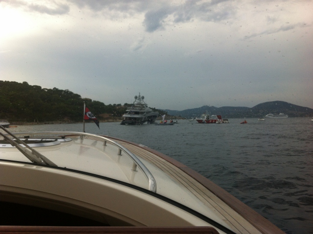

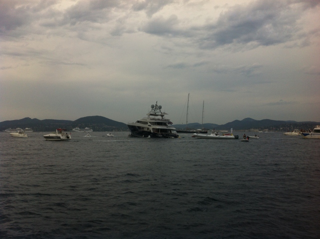

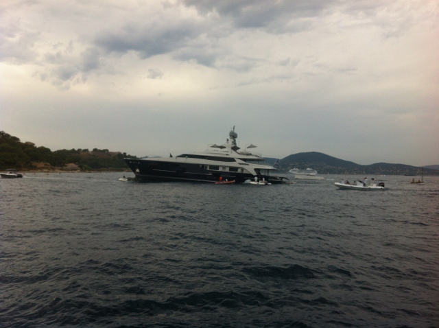

    A friend of mine took these pictures. He had spoken to the recovery yard and was told no serious damages were done.

    The question is how are these megayachts going down so easily. Is it a lack of proper crew training? Engineering disasters or what? This yacht is in shallow water that appears to have been relatively calm.
    A greek owner of many yachts that I've dealt with a long time and trust, told me that on Yogi, the doors flung open and possibly fell off, or would not shut, the yacht had been in the yard for warranty repairs forever and HE feels it was insurance related, and that the crew left the engine room watertight bulkhead open......so garage filled, flooded engine room, end of story. He said he got the story from a good friend in that area..... But the design of the transom doors was ill-engineered and allowed the sea to break them open rendering no way to secure them shut, the crew had the engine room watertight door open allowing the engine room to flood, and the way the *NEW* to the boat crew handled it after that fact sealed the deal (which he also thought was extremely strange).
