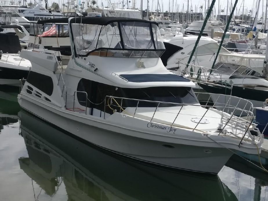

    This would be the BW houseboat? Can you send a pic to verify the model? There were a couple or more BlueWater brands out there.

    This is the model of Bluewater.
    Thanks for the tip about particle board. I wasn't sure if that was a concern or not. This is my first boat purchase, so any information helps.

    Yep, We know the model now. Gas or diesel?
