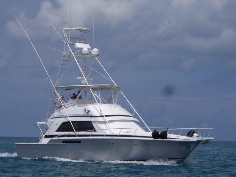

    Its time to move up from our 50ft bertram. Amazing boat which we refit and love, but boss has us chartering south this winter and its time for more space for guests and fuel for crossings. Any thoughts on these two carolina boats? I respect there are many others, but these are within our budget.

    Hey guys. Really appreciate the feedback, especially from CaptJ. Sounds like we can tweak the 58 to suit us. We arent looking at new build as budget is set at 500k with additional for modifications after purchase.
    I took our 50 and turned her around. Looking forward to doing it again. Its such a great boat, but just need the extra quarters and speed.
