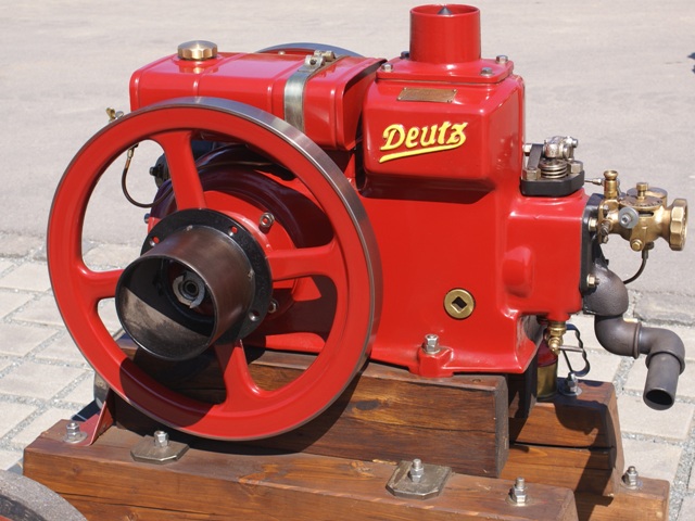

    We have one very old truck (from 1951) and a much older small diesel tug boat which run both happily on bearly filtered vegetable oil which was used for frying french fries. Only the biggest pieces of old potatoes have to be filtered out :). The exhausts smell like a burger shop, thats all. The oldest diesel engine in our inventory is a more than 100 year old stationary Deutz single cylinder diesel engine, which was used as a fire pump.
    That beast would run on rancid butter, if needed :) or any type of salat oil straight out of a grocery store.
