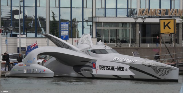

    Earthrace
    01-09-2007, Amsterdam het IJ. How about this one.
    This awesome ship will attempt to break the worldrecord for a voyage around the world running on 100% biodiesel.
    read all about it at:
    http://www.earthrace.net/index.php?section=2

    Welcome to Yacht Forums.
    This is not the first attempt to do this by this boat.
    It has been written about before here on YF for the previous effort.
    http://www.yachtforums.com/forums/g...415-earthrace-2006-a.html?highlight=earthrace
    Here is some press news for the next effort.
    http://www.yachtforums.com/forums/g...611-earthrace-2008-a.html?highlight=earthrace
    100% Biodiesel does not mean 100% non fossil fuels. I have been interested in this subject for quite a while and have found that the normal ratio of standard diesel fuel to vegetable oil mixing is 80% to 20%.
