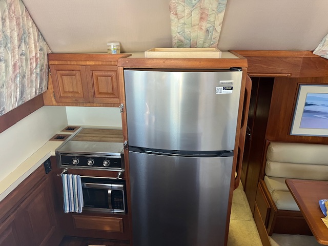

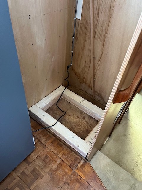

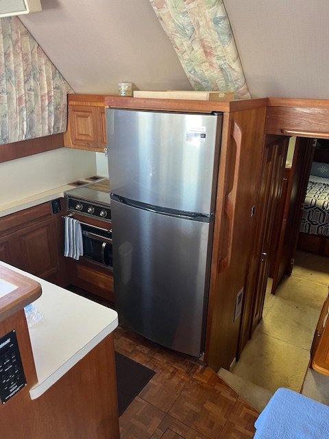

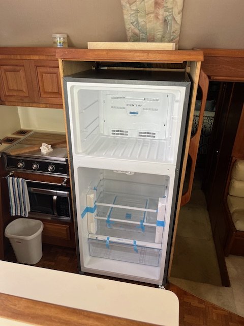

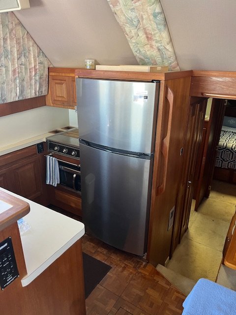

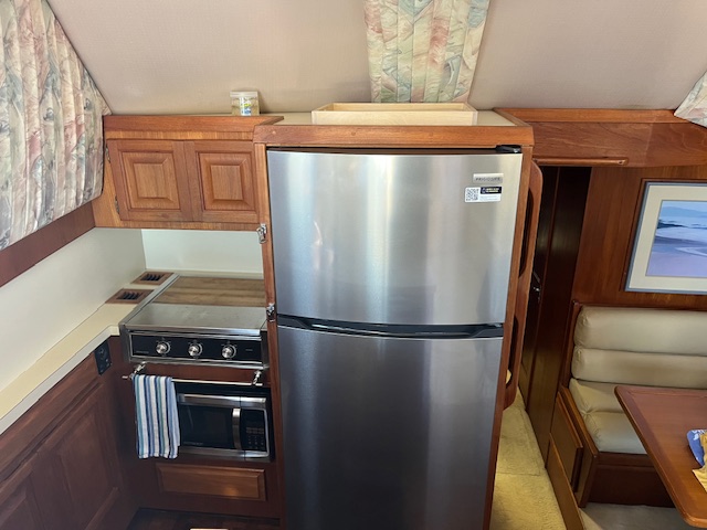

    We replace ours in our 89 45SF last summer. Found a Frigidaire 13.9 cu ft that was darn close to the same dimensions. Got it in the boat through the rear sliding door after removing the doors. Found it was a little short so built a pedestal to correct and its been doing great. Hope this is helpful. Mike

    Yes, put the same one in my 44 6 years ago, been working great, also had to raise it about 3inches.
