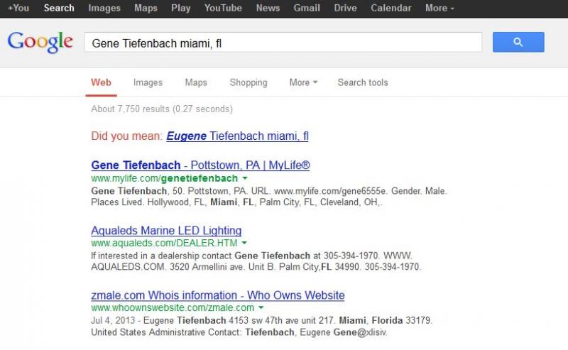

  10. YachtForums
    20,956
    I had to search in the shadows, but I finally found the light...
    Gene, you were warned multiple times in YF's registration process NOT to pose as an independent 3rd party; promoting a product or a service. You were warned that we would expose you, but you disregarded the warning.
    Now it's our turn... let this be a warning to anyone reading this thread that "AquaLED" engages in clandestine, fraudulent tactics. You have disparaged a competing manufacturer. This type of conduct is the lowest form of scum and we will not tolerate manufacturers attempting to mislead our readers.

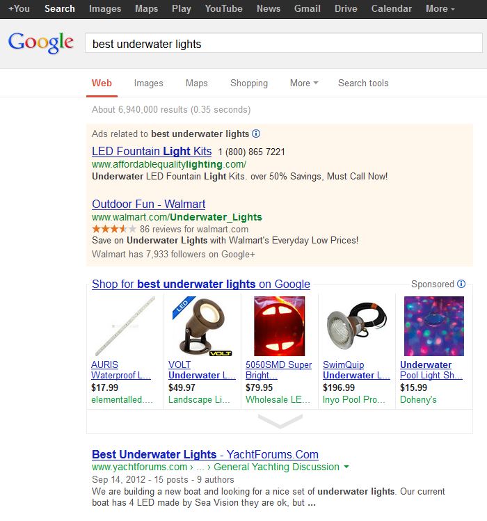

    Congratulations Gene, this thread tops a search on Google...
  11. YachtForums
    20,956
    And how did I know it was you? Because STUPID criminals are the easiest to catch...
  12. YachtForums
    20,956
    To anyone considering AquaLED, be aware this marine business appears to be funded by a network of porn websites. The domain extension, the same as Gene's screen name, has been flagged by Google for malware. It's a reported attack site.
