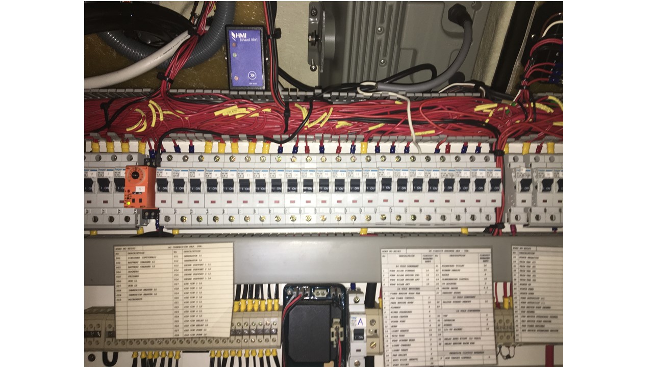

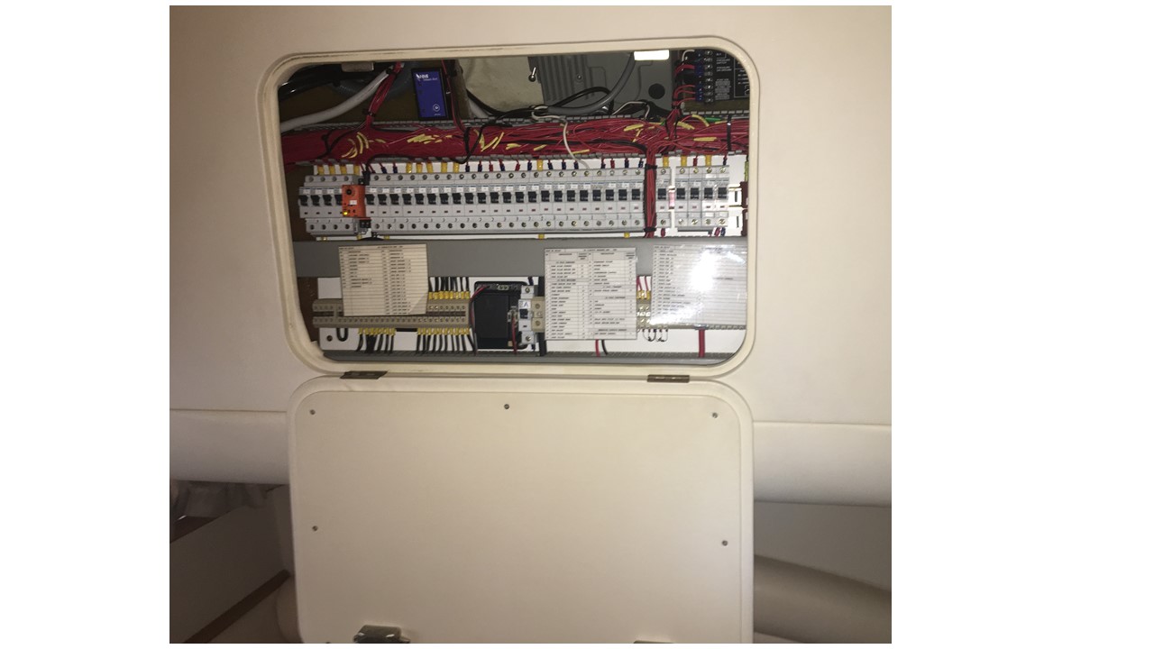

    Capt J will you please define poke and stick wiring. I am unfamiliar with this method and can find no information in books or on the internet. As I stated earlier in this thread, I have found my wiring to be well thought out and reliable in a now 20 year old Princess/Viking SC. Below I have posted a couple of pictures of the 240/120 breaker panel and the main 24 V panel and backside wiring.
    Can you describe what is poke and stick wiring in the easily accessed main electrical panels shown in the pictures? Those breakers, connectors and power strips all look like standard DIN mount, properly labeled, screw tightened electrical hardware to me.

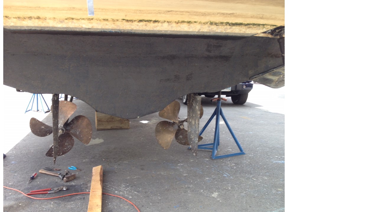

    Hi, I think chop and wind driven seas are where the Princess/VSC hulls do best. They have a fairly high deadrise (mine is IIRC 21 degrees) and forefoot/entry and as such steep head seas is where they are at their best, how they track in steeper following seas is also a strong point. On the other hand, in a strong head wind, without any real flare up front, it can be wet on the fly bridge. The other price to pay for having a a high deadrise is that at anchor or drift they tend to roll more then say a typical sport fish.

    Poke and stick is where there is a spring tensioner that makes the contact with the terminal. Yours appear to have a screw terminal which is better, but also has a tendancy to loosen (not as badly as poke and stick) because there is so much plastic in the terminal blocks/breakers etc. that heats and cools off and the screw base is the only thing that provides tension. I'd recommend turning off all AC power and taking a screw driver and checking tension on every single screw on your terminal block.
    A 2001 VSC I dealt with had all poke and stick. The newer ones have some from what I've seen.
    The two terminal strips in the bottom of the picture have a much better way of tensioning the connections, the top row is poke and stick stuff but looks to be very light load DC stuff.

    Your definition is what I assumed, but wanted to be sure. There are NO poke and stick terminals on my VSC boat. Every breaker panel has screw tightened terminals and none are of the spring load type, which I agree are far less reliable. I have not observed any of my screw tightened breakers or terminals coming loose. Perhaps because there are no overload conditions and so no significant heating and cooling issues and no real corrosion in the electrical panel areas - those are original 20 year old wiring panels.
    Are you sure about the 2001 - sounds like a big change from how they did all of the wiring on my 1998/9 boat.
    There is NO poke and stick in any of the above pictures. The top row in the top panel is indeed screw tightened breakers and in fact the 24 volt light load DC breaker layout has been very reliable and we never have had a breaker pop unexpectedly in 11 years of ownership.

    Looks to be Merlin Gerin equipment. Schneider electric makes a quality product and is in use on some of the finest yacht builds in the world Oceanco and Lurssen to name two. Sometimes J gets a bit ahead of himself. Absolutely nothing deficient in your circuit protection equipment quality wise.

    I was referring to the picture that I posted the link to(top row being poke and stick).

    Princess and Fairline and also Azimut from the nineties all had Bernard Olesinski hulls. A hull design very much inspired to a Napier design IMO less entry and similar closing aft.
    The Olesinski hull usually enters at about 40 while if I remember well the Napiel one enters at about 45 to 50.
    21 degrees deadrise aft is unknown in a Princess as far as I know. Princess all had 15 to 18 degrees deadrise mostly 15. The new ones 2010 onwards are 12 to 15.
    The only 21 degrees deadrise closing (pure deep Vee) Olesinski hulls I know off are for a couple of the smaller Fairline Targa models the 37 and old 30/33 if I remember well.

    When I bought our 98/99 50 ft VSC/Princess I looked at dead rise, entry and forefoot (maybe 75 percent forward) closely as having a wider weather window was important as we both still work. I still have notes somewhere from a few azimuts, sea ray, Navigator, Fairline and a few others that were on the hard. At the time the Bernard Olesinski hulls as I remember had more deadrise aft and in the forefoot.
    I will be back on mine this weekend and can easily measure the deadrise aft (in the engine room) I have a nice digital level that makes it easy. I will post numbers and a pic this weekend. I remember 20 or 21 degrees, we will see. I do agree the more recent hulls are a few degrees flatter

    The new Princesses that I've seen out of the water......the 55' F and the 62' F seem to have a pretty steep deep V in the stern. While I haven't measured them, they sure look closer to 20 degrees. I'll be looking at the hull of a 52' tomorrow out of the water.

    At least with regards to the late 90’s early 2000’s Princess/VSC (unsure about the newer ones), they have a pronounced reverse chine, which specifically helps with aft lift and stabilizes the boat both at anchor and while underway. They also use strakes for stability and lift and prop pockets. All of these have a positive effect on fuel efficiency on a boat with a deeper vee. As Fiammetta42 said, it’s the entire package.
    The Princess/VSC are on the lighter side due to the extensive use of molded stringers and bulkheads (my 50 ft flybridge is ~42,000 lbs loaded) and benefits from the deeper vee in a head sea.
    To clarify your comments on stability at anchor and underway - stability includes roll, pitch and yaw. The deep vee helps slice through the waves while underway, but generally degrades roll stability. Strakes and chines help with roll stability. A gyro helps with roll stability but has no effect on pitch.

    I measured my deadrise aft (50 ft 1998/99 VSC Princess) using a digital level inside near the dripless shaft seals and it was 19.5 degrees, but that could be slightly off as one cant tell if the laminate is a constant thickness near the keel. I did find a picture, that I attached here, that measures 20 degrees deadrise aft. The prop pockets are obvious in the picture but on either side is a straight 20 degree deadrise.

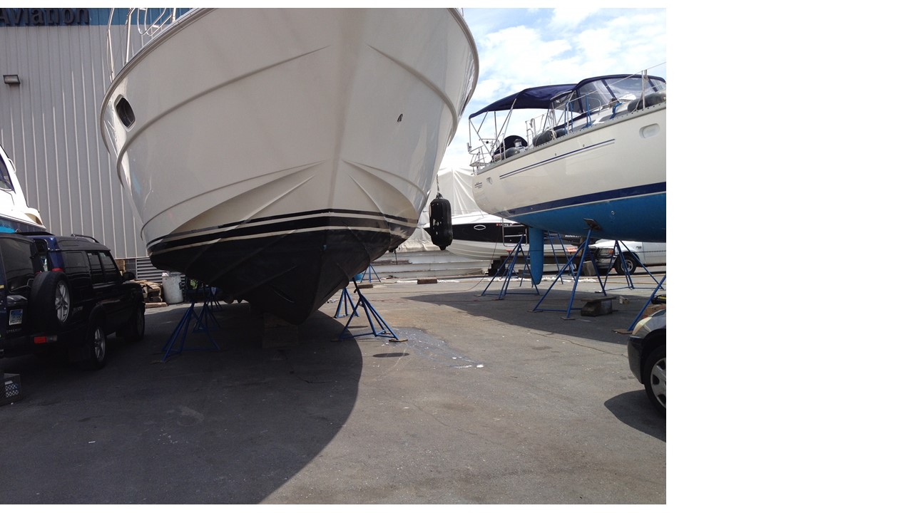

    I also found a picture of the hull forward that shows the forefoot around 35 degrees but also the strakes and start of the reverse chine.

    I would say that is 18 degrees more or less how are most of Olesinski hulls. Actually his best hulls are the 15 degrees as on the old end 80s Fairline 50 IMO, and Princess 55.
    New Princess are less but unlike the old one have even less fore deadrise.
