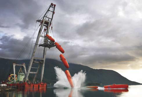

    Sandwich "Boat" Drop Test
    Thought I would share what is possible with properly designed and constructed lightweight sandwich construction....
    Schat-Harding FF1200 50 meter /180 ft drop
