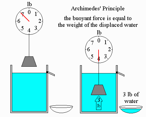

    Bouyancy of fuel tanks is about 1.5 lbs per gallon of fuel and 7.4 lbs per gallon of air. I would guess the tank capacity at around 900 gallons +/- 150.
    The vessel only weighs 100,000lbs in air. The specific gravity difference between air and salt water are considerably different and you have to use the differences in SG from all the materials in comparison with salt water to figure out its weight under water (however, its mass/inertia and kinetic energy while hitting things underwater does not change)

  9. PropBet
    PropBet Senior Member
    Apr 21, 2007
    1,214
    Is Everything!
    What?
    And you ran (or worked for) a salvage company?
    You're killing me, Smalls.
    With all due respect Henning, please read and understand Archimedes' principle and the laws of buoyancy and displacement before you quote things like that.
    If the boat weighs 100,000 lbs, and it's in salt water, you should know it's exact weight underwater based on a simple displacement calculation.
    You can read about it here:
    http://en.wikipedia.org/wiki/Buoyancy
    Specifically:
    Picture attached for the lazy.
  10. Marmot
    Marmot Senior Member
    May 20, 2007
    3,300
    9114 S. Central Ave
    While it is not my wont to jump to Henning's defense, you are a bit off base my subsea sniper.
    Several submersible vehicles use a ballast system that transfers oil from a "hard tank" to an external bladder. When all the oil is contained within the bladder the vehicle is either neutrally buoyant or even negative, depending on the fixed ballast installed. When oil is transferred from the tank to the bladder the vehicle becomes more buoyant.
    In either condition, the weight of the vehicle has not changed a single ounce.
    Likewise, if my submersible is too heavy in the water for the job I want to perform, I can add weight externally to correct that condition. Sounds really off the wall, right? Not so, the weight happens to be syntactic foam which has a density less than water. It is heavy as hell but still less dense than the water it displaces so even though my boat is heavier in air, it is lighter in water.
    You forgot about density ... and Henning did mention that the mass remains the same as does the inertia available. Trust me, after having rammed a neutrally buoyant 5-ton submersible into an immovable object I can attest to the fact that a "weightless" object can still do some serious damage.
    Go back and revisit what Archimedes was looking for when he weighed that crown.

    I'm quite familiar with density in how it effects buoyancy and how it applies to Archimedes' principle. My reference was to Henning's post, which made absolutely no sense with how it was presented.
    If you wish to take the topic up in another thread, I'd gladly debate the issue. However we are talking about physics, that of which neither you or I an change the properties of. So the end result is going to be the same. Physics will win. And I can gladly explain the oil / bladder / tank / buoyancy topic, and why it is the way it presents itself at face value.

    Of course it does.
    It doesn't weigh 100,000 lbs at the bottom of the ocean.
