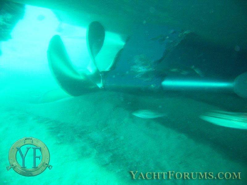

    Far, I'm not saying you are wrong in any way. I'm just exploring my own theory.
    My response to the three items listed above in your quote...
    1. upward force from the lines on the transom cleats upward to the tug.
    2. But where was it moving through? The salon? The salon bulkhead is still there in one piece so tons of water didn't rush through there.
    3.Correct. There very well might be a small pile behind it but being pulled backwards but the rake of the prop would be sending sand in the opposite direction. There was possibly a last stitch effort where the boat was moved slightly forward too (missing tower with legs bent forward??).

    Looking at the prop trench digging observation of mine, look at what appears to be something resembling a sheet or cover which obviously was caught by the prop. It's leading forward, away from where it's been dragged. Yet another sign of the boat being dragged astern.
    Tower was torn off eh? Legs pointing forward huh? You could have hit a brick wall & the tower wouldn't have been ripped off not there at all. The initial impact might break it free but all the cables and wires would act like rubber bands & kept it on what remained of the boat. It could be torn down but it would be there, hanging all over the boat. Yet another attempt to drag it after dragging astern failed? It would have been the last easy thing to grab with lines.

    Cant explain the trenches, it could be the tide ripping through. Not to sure.

    Look in the sand running below the prop shaft.

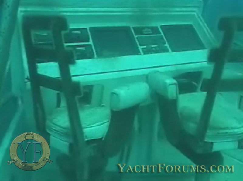

    Ok, we seem to be over the bow blowing apart and the myseriously missing transom and tuna tower. Lets explore the bridge console.
    Looking at the picture just above and left of the Yacht Forums "YF" port hole logo, you can see from the angle of the port side railing on the top/outer edge of the bridge that the console is shifted back (more so on the port side) as well as being on top of the rail. The console is up, back & crooked. I also see that the port side arm rest of the port side seat is inside the cabinet opening (follow the arm rest which the inside surfaces are covered with white vinyl). Looking at the height of the opening vs. the height of the helm seat arm rest, the whole console had to be lifted up, pulled back and dropped back down. All this damage to the helm console yet the "upsweep" from the bridge to the deck and the sides of the bridge are completely in tact. Is that the remains of the steering wheel inside the opening in front of the helm chair or a wiring bundle?
    Does anyone have a pre accident picture of the bridge? I bet there were a couple of aluminum struts from the missing tuna tower that were mounted to the now repositioned console.

    this is what your after Dave...? and why we back on to this? if we unlock what happen to the boat in the first place (the bow), it will more than likely answer why the bridge/transom is why it is. cheers
