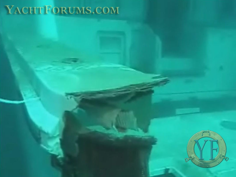

    Questions for the structural experts:
    In my experience from destroying fiberglass by offshore racing, This does not look like "impact" damage. To me, it appears to be pulled apart/sheered off as in force from something "pulling" from astern. Even the stainless steel rub rail is sheered off, not impacted. It would be bent.
    Your thoughts?

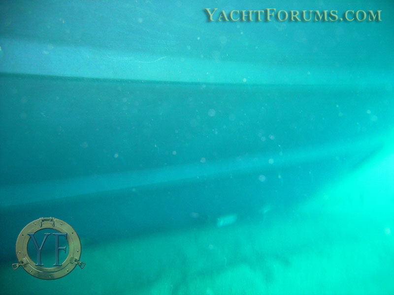

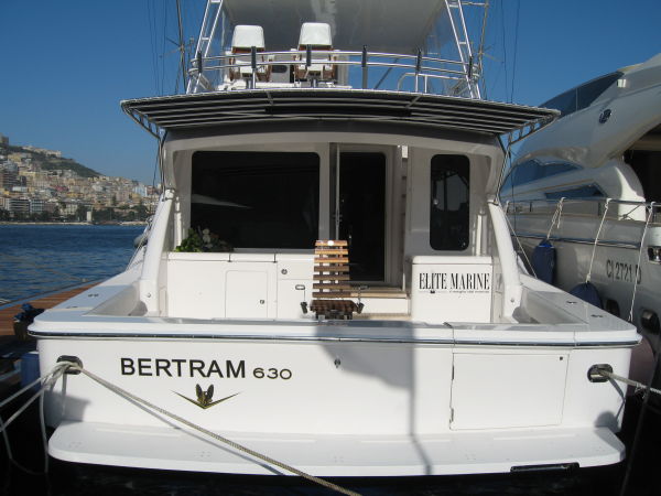

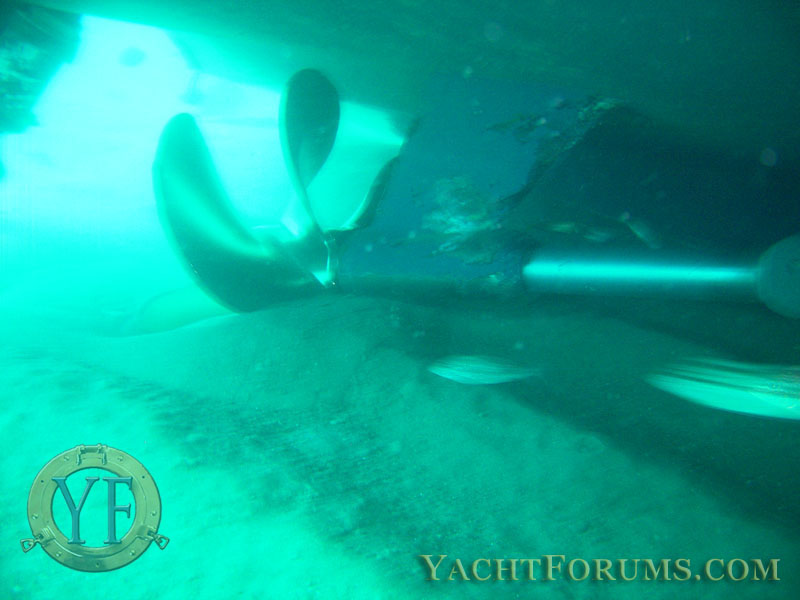

    Second question:
    Take a look at the sand & in particular, the trenches (or furrows for those who have plowed a garden) which lead forward toward the bow.
    In the second picture, see those same trenches in the sand up near the bow?
    Now look at the third picture. Look at the sand behind the boat. Untouched.
    Stern sheered off, rudder strut ripped to the rear, trenches leading forward...
    It's kinda like it was being pulled backward with great force. Someone said they felt that the transom was damaged when the boat impacted the bottom. There is no way the boat was going that fast and if for some reason it did happen this way, the transom would have been there.
    In my opinion: fishy, fishy, fishy

    personally, i think the transom (first pic) came off when it hit the bottom... if it was ‘pulled’ off there would be stress cracks and splinters running towards the bow of the boat along the gunwhale, there is not. As u said, sheered off. As u can see at the end of the fibreglass (the break), is pointing upwards, to me that means that there was an upwards force generated below the boat… like it hit the bottom (speculation). I read somewhere that the boat was reported as sinking stern down, because the fact is there’s not really a bow to hold any water, it will likely get trapped at the stern (with its deep V). correct if wrong?
    Now just before it went under, the force of the water (a f##k load of it), is rushing down to the back of the boat, moving the LCG (longitudinal centre of gravity), and also the CB (but the weight of the boat will obviously overcome it) towards the stern, this will cause massive stress loads on the transom (delaminate it) and likely blow out hatches. So when it’s rushing to the bottom, all 110,000# of it, she will hit with a lot of force. And depending on angel of attack when the boat has hit, could/will/has also increase the load on the transom because the LCG has moved towards the stern, so it just snapped under massive loads basically. Correct if wrong?
    The trenches could have been down by the diver taking the pic. If the boat was pulled the deposit of sand would be behind the prop… not in front like in the pic. Correct if wrong?

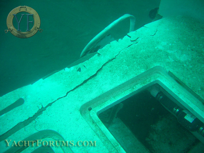

    hi , i tend to agree with CT DAVE . just my 2 cents worth , but if you look at attached photo and notice position of the cleats . someone or something pulled the boat backwards, breaking off the transom . when that effort failed, then tried to pull using the shaft strutt , hence the markings on it .

    who says it was not semi submerged , and the aft cleats were the only means of securing a line , as the front cleats were not there . all is speculation , hopefully we will all discover the "truth" one day .....
